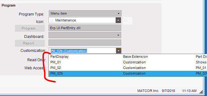

We now have a working Test system at 10.2.200.8 based on our old 10.1.400.18. We also have some solutions pre-prepared to fix issues we know to expect. But some menu items are not allowing us to select any customizations. There is nothing in the dropdown, though an existing customization already in place appears to be honoured. If you try to change it, though, even that disappears.
We’ve been through the verification steps, so Customization Maintenance is reporting no problems with the relevant customizations. I’ve looked in the Ice.XXXDef table, and the only difference I can see between customizations that show and ones that don’t is in column DataBaseVersion, which isn’t accessible anywhere in the UI that I can see.

Seems to be a bug. we had the same and had to save the customizations with the all company’s box ticked.
I’ve just tried that on one customization, and there’s still nothing in the dropdown.
Epicor support say there is no bug so it can’t be happening, which is leaving me a bit frustrated.
So when you query the ice.menu table do you see the customization in the arguments column -c ?
No, not now.
One was there until I tried to change to a different customization. Because even the one that was there isn’t in the dropdown, it wiped it.

I think there’s more than one, but my test case for the moment is POEntry, MenuID PMGO2001.
They renamed some of the forms in a 10.2xx version (not sure if this one) which causes that dropdown to now show them. You can use a UBAQ to update the customization in the menu and it still works…

We had the same issue, though POTracker wasn’t showing rather than POEntry, as well as a few others. Epicor has a hot fix for this. The issue number is PRB0204581.

I have several customers that have encountered this issue and have successfully received the fix from support.
I did see these notes in one of the replies which may help expedite getting the fix for you.
Per development, they told me that the SCRS changed to ERPS-95108
Thanks a lot. I’ve tacked that onto my communication with Support as well.
And my reply from support is that the fix is for Engineering Workbench only, and that I should put everything on hold until 10.2.200.12 is released and our contact is back from holiday.
