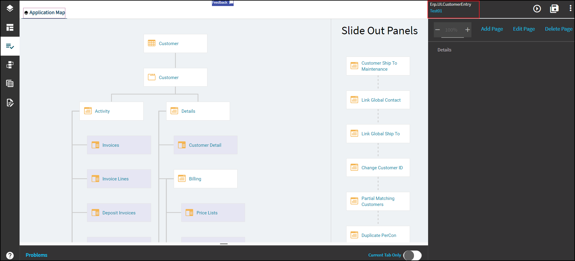

System-wide - Context menu maintenance.
Set up a menu item with that layer. Make a copy of the context menu item and point your copy to that customized menu item.

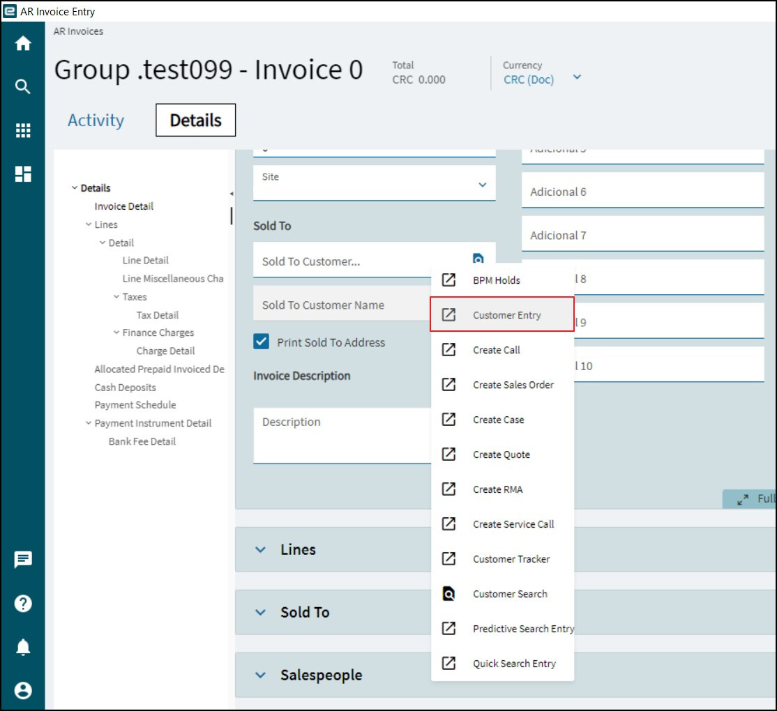

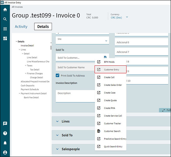

Local context menu - Make changes to the context menu for just the page you are on.
In a layer on AR Invoice Entry, go to the related data view (in this case, it looks like it would be InvcHed) and add a Custom Context menu item to the SoldToCustID or SoldToCustNum that points to an event with the app-open widget pointing to the Customer Entry app and your customization layer
