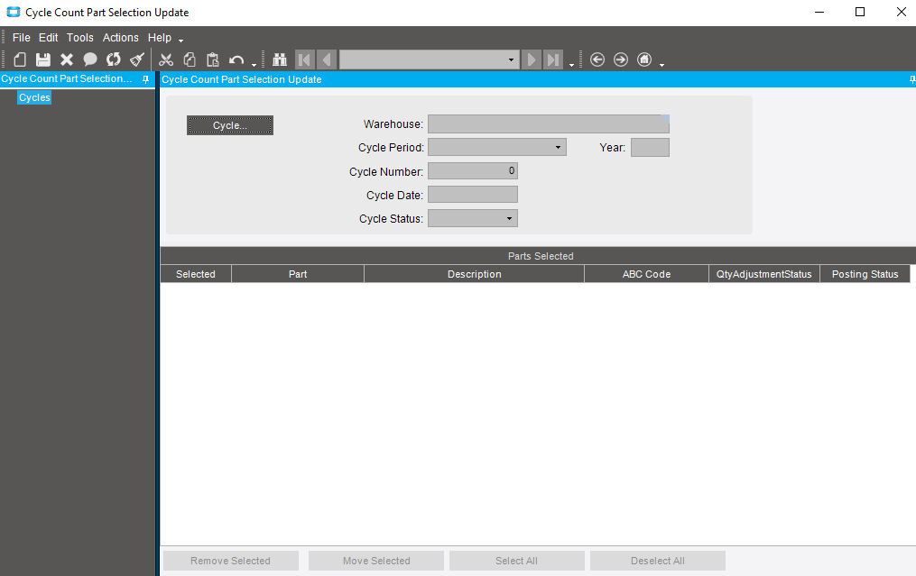

However, all is not lost. Epicor allows you to alter the parts selected in a cycle count using this command:
In a previous life, the cycle count program was, “count all the parts that had activity since the last cycle count, then add in some inactive parts to ensure all parts are counted within their class requirement”. It usually ended up being around 80-120 parts a day. With three warehouse workers, it was done in about twenty minutes. (They used tablets with a custom web page but that’s another story…) They passed quarterly audits from the outside finance auditors and haven’t run a full physical since launching Epicor in 2015.
The process was to run two BAQs: one for active and one for inactive parts. They would paste into the Selection Maintenance screen above all of the active parts and then grab a few from the inactive parts that were due to be counted. You could do something similar by area.
You will be manually managing this so please certain that you count enough parts each cycle to fulfill the set requirements for the various classes.

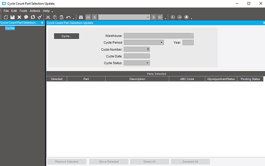

Expanding on @Mark_Wonsil’s solution, I created a dashboard to find parts by bin location, then used to paste update in the cycle count part selection.
When you do this, you will still get a tag for any other bin location in that warehouse for the parts you add to the count group.
