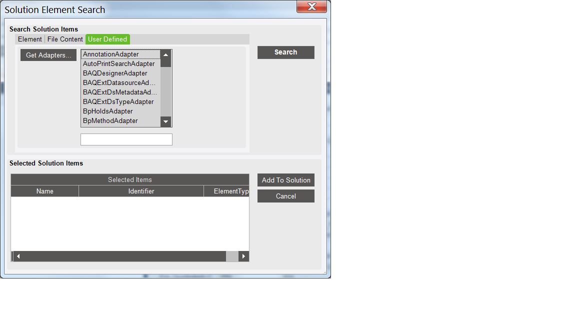

Have you tried the solution workbench adapter method in E9. In E10 this feature is available? I am not sure about E9.
