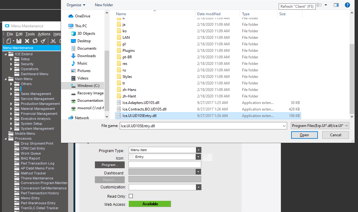

Don’t know about better, but each UD table comes with its own application to manage it. You just add it to the menu and then you can customize it. For the UD*A tables, it comes with the parent-child panels already done for you.
You can make it Read-Only in the menu as well.
Mark W.

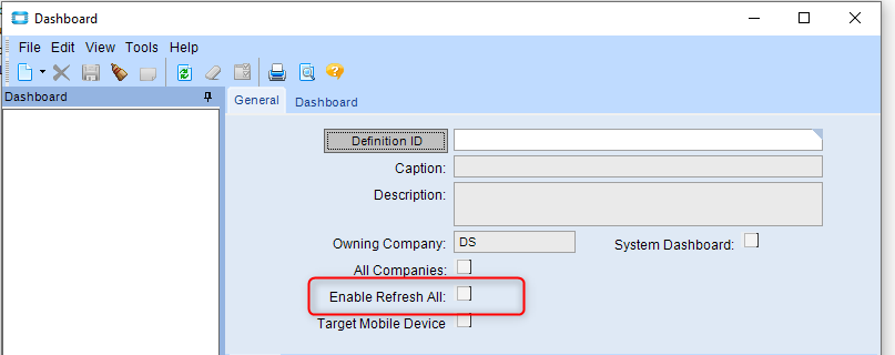

@snguyen hmmm, I don’t see a Refresh All button, nor do I see a RefreshAll method through reflection?
@JimF it is in Dashboard General tab
@snguyen - Doh! Thank you. OK, enabled the Refresh All button, but still the same results. It seems that once the top row becomes the ActiveRow, there is no way to reset that (and subsequently refresh/repaint the 2nd sheet) without physically selecting another row on the first. I also can’t find anything that will do it programatically.
