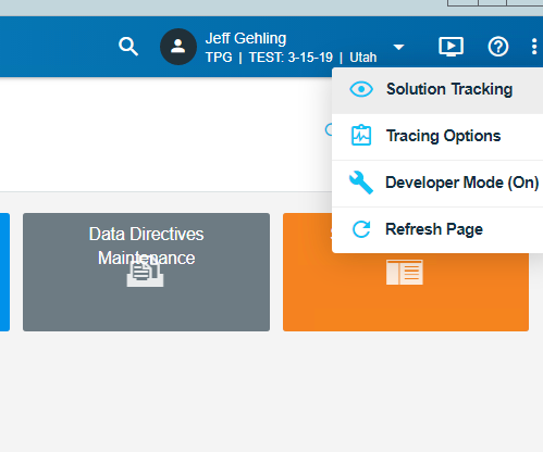

@jgehling I am not sure how to run the client trace or analyzing it. Do you know if any resources I could look at to figure out how to do that>
Here is a great overview video of the tool:
You would need to enable the trace log in the client via tracing options:
In the options ensure “Include server trace is on”
Then in PDT load in the txt file under client trace analysis. Typically rows highlighted in red show potential issues in the client trace.
