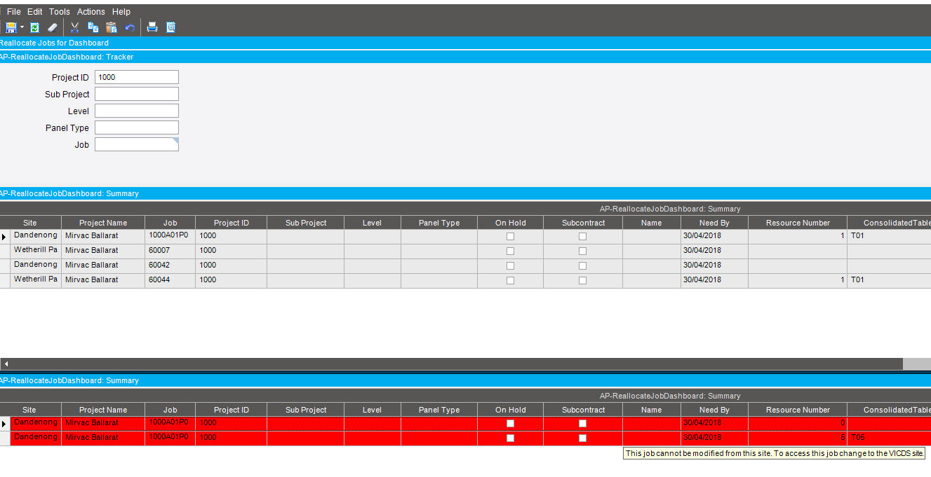

I am creating a dashboard for a person who manages three sites. He wants to be able to change properties of a job on another site that he manages.
On the dashboard, if he launches it from Site A, he can only modify jobs on Site A, is there a way to allow him to modify jobs on Site B?
I have mock up the dashboard and this is the error that pop ups.
"This job cannot be modified from this site. To access this job change to the XXXXX site.
