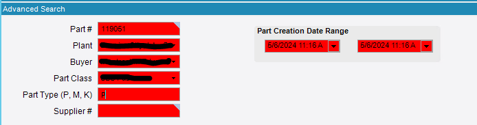

Hi, there is no text error message but the filters in the dashboard get highlighted in red, and the changes I make don’t take effect in the part master.
Which fields are you trying to update? What does your BAQ look like?
Try to do the same change in part entry and you should see the error. If this is your update then you can add a try catch and then grab the error and put it in a calculated field in the baq
I am trying to update the buyer field. This is what my query looks like:

Usually when it’s red like that, you can hover over a field and it gives you an error. I’m not sure if it works in that advanced search view, but if you’ve got a grid view with a row in red, the hover usually gives you the error.
Also, if you can’t do something using the standard Epicor programs (meaning you can’t do this cross-plant update), doing it via an updateable dashboard should give you the same error. There are ways around it, but that would likely involve BPM’s/Customizations to work around Epicor’s Business Logic. And, working around Epicor’s business logic usually has a lot of pitfalls, so it’s not recommended.
As mentioned earlier, try the same update within the BAQ Designer and see if you get an error message.
If you’re attempting to update PartPlant, you’re missing fields from the primary index from what I can see. You’ll need all the fields from the primary index included in your BAQ. You don’t necessarily need to show them in the Dashboard, but that have to be in the BAQ. For PartPlant, I think that’s Company, Plant, PartNum.
