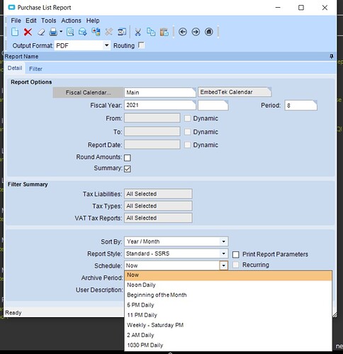

After the SSRS Report has been created and uploaded back in, how do I tell it to email daily?
you will have to run the report.
Then set the schedule to what you want, and then set the email and what not.

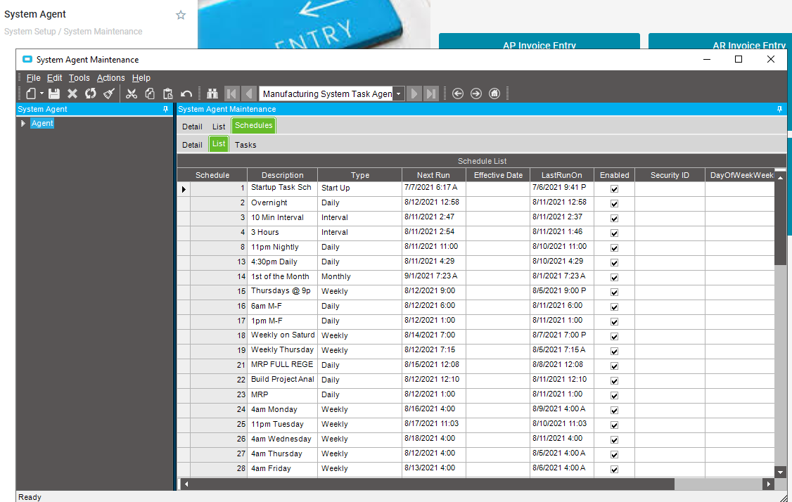

How do I add additional schedule times? I only have Now, Daily Midnight, Daily 4:00am
You are awesome Aaron!
