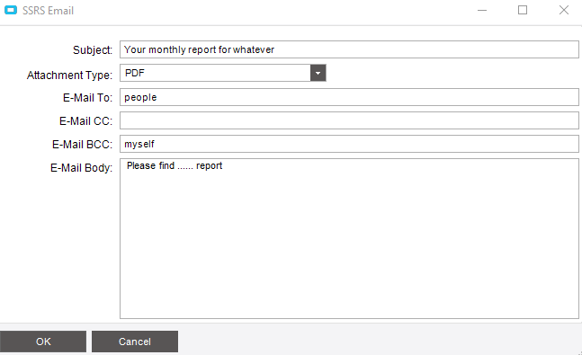

In a nutshell, I created a BAQ report that referenced the BAQ. Then some light formatting in Report Style will get you a neatly formatted PDF report. When satisfied, you will Test Print the BAQ Report, change the Schedule to your previously created schedule. Then check the Recurring box. Instead of hitting print preview at the top of the dialog, you’ll click the Email button. Then fill in the recipients and the body.
