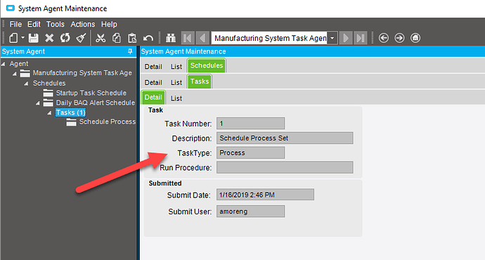

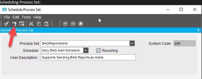

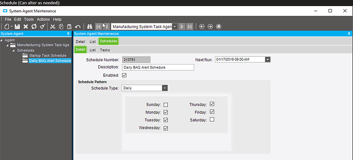

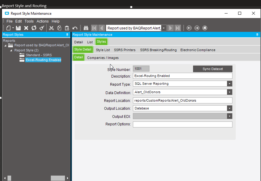

The easiest thing to do is to create a breaking/routing style for the report and then attach it to a process. Then, you’ll schedule the process with the System Agent menu item.
Create report style with breaking/routing defined (who it goes to, etc.)

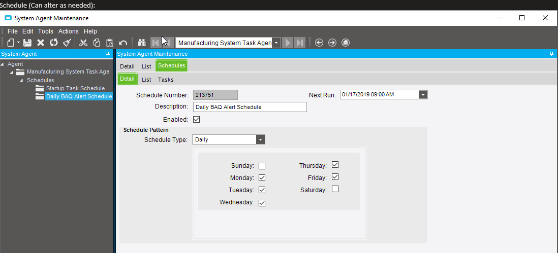

Create a Schedule

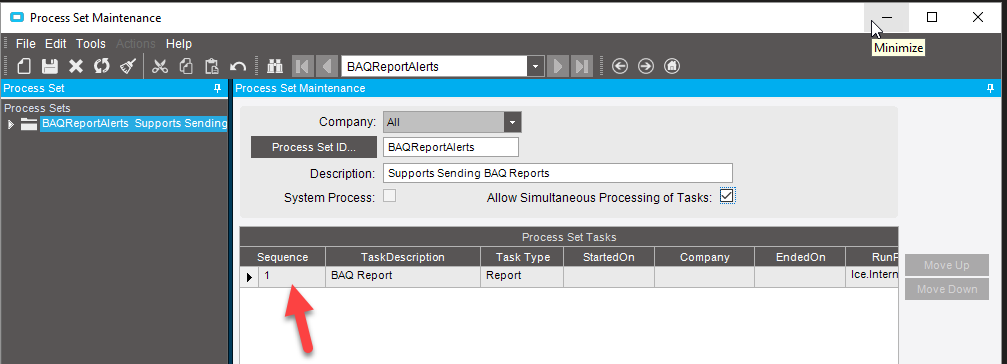

Create a process set (note, this set already shows the BAQ report attached to the process set, but at first it will have no tasks associated with it. After to add a task to a process set, it will show here)

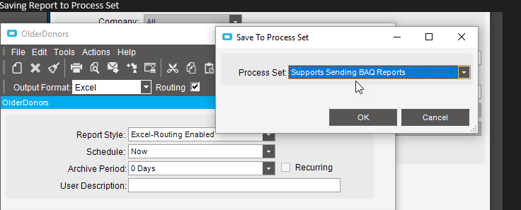

Invoke the report style (routing enabled), but instead of running the report, choose the option to save it to a process set. Choose your process set and submit
Add your process set to the schedule in System Agent
Just make the Routing like if you wanted it to run immediately. Then when you run it, choose the schedule, and recurring checkbox, on the BAQ Report form (the windo that pops up when you want to run the report).

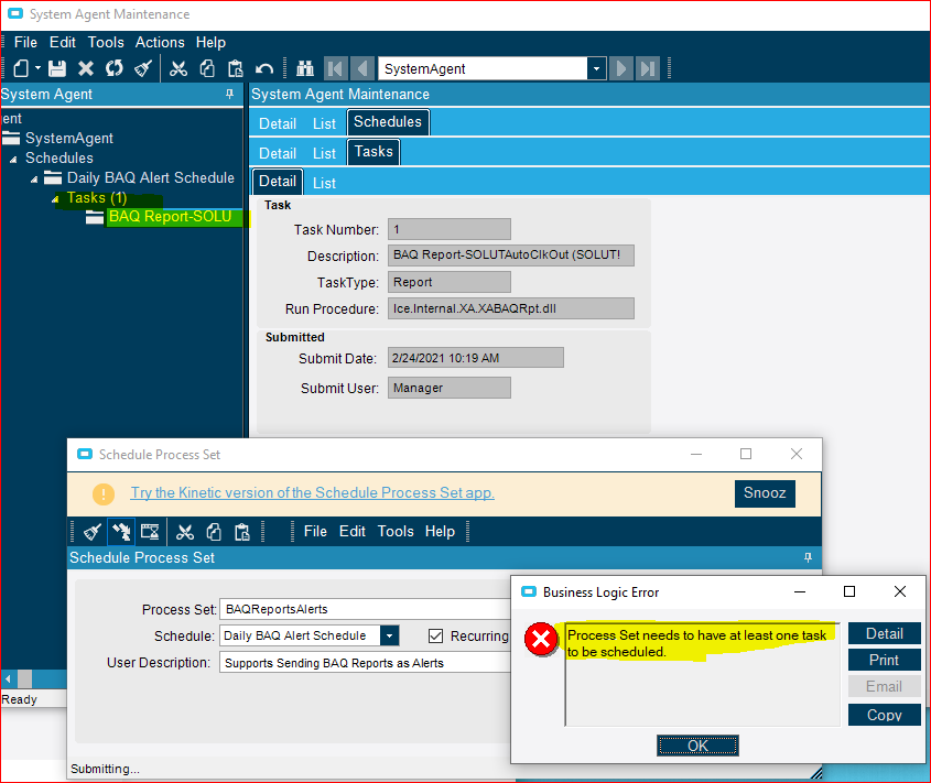

Thanks for the steps. I tried it but giving the below error message.

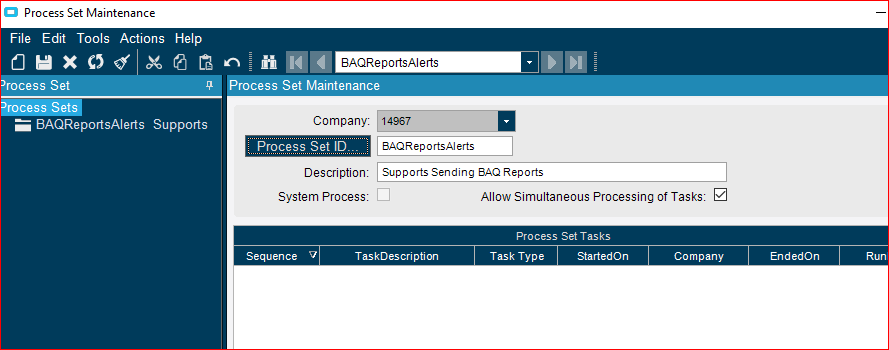

Add the “task” of submitting the report to the process set first before trying to schedule the process set
Aaron, I am not finding any option to add the task in process set maintenance.
It’s actually in the baq report itself when you go to run it. Instead of submitting the report to the task agent or generate report, choose the option to save the report to a process set
Got it Aaron! I am testing it, will give you an update.
Subha
Thank you so much Aaron its working great.

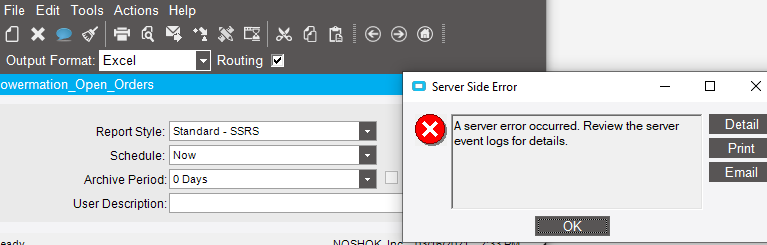

Aaron, When I attempt to save the BAQ report to the process set I get a server side error. Have you seen this before?
What does the server event log say
I ended up not using the process set and did this instead.

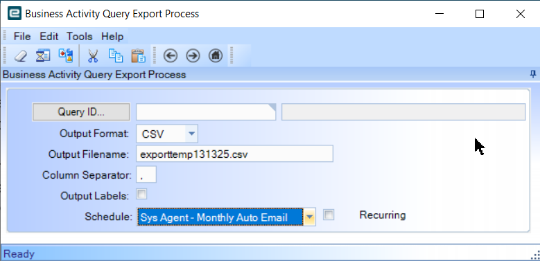

I have the Schedule made, i have the Process Set made, i’ve tested these and they all work, the schedule runs, the Process Set runs and the task ‘BAQ Export Process’ runs and i can download the document through the ‘Server File Download’.

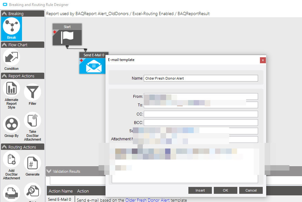

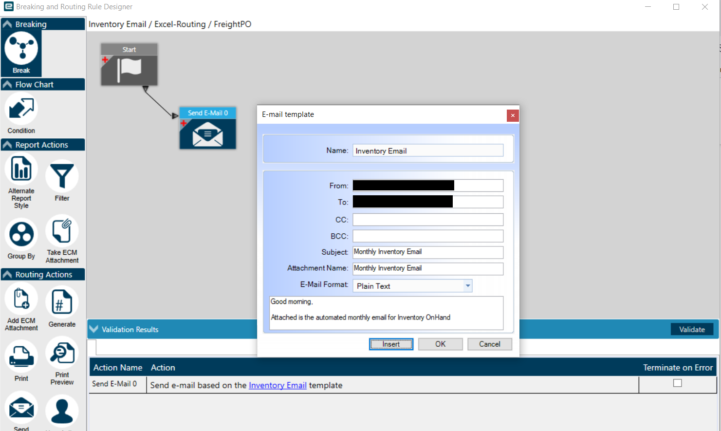

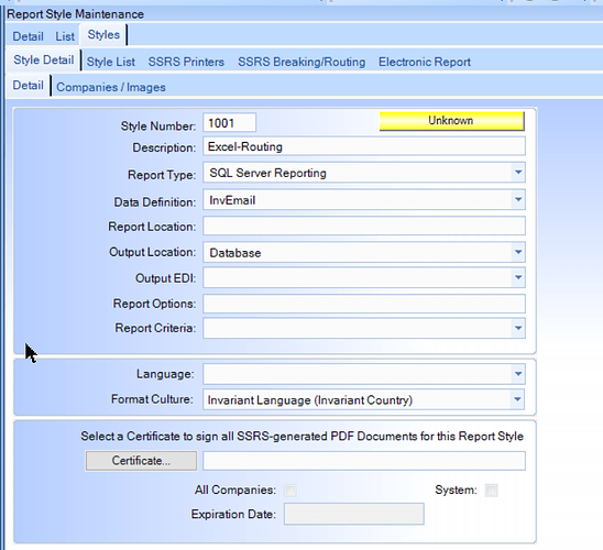

As the name of this thread says, we want to email BAQ results on a schedule, again i followed the instructions above and made the report style…
Added breaking/routing with ‘Send Email’…
The ‘BAQ Export Process’ does not have a place to invoke a report style. So how do i get the report style with email conditions to work with this?
The BAQ export isn’t a report, it’s just the data from the BAQ. You have to schedule the report.
