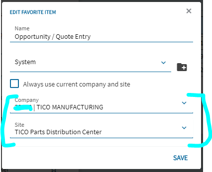

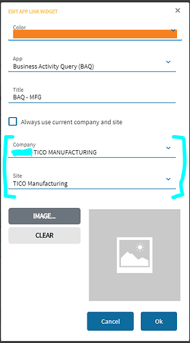

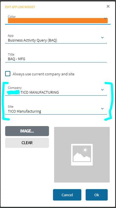

A home page tile in Kinetic
A side-panel shortcut (the star):
And I haven’t used “Modern Shell” in a while, but I think you can do the same there.

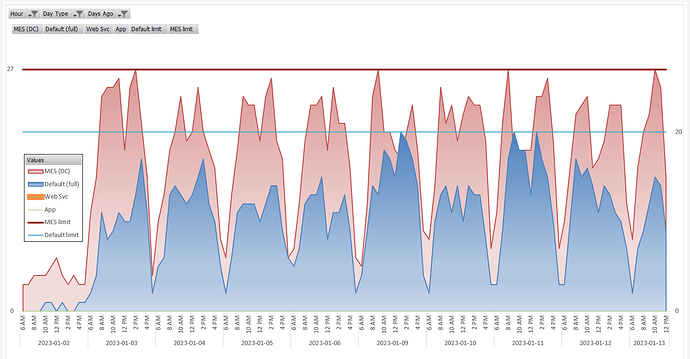

I personally just made my own log, updated by an Epicor Function.
You could easily throw an email in the Function, based on a condition.
Also, I improved my Excel chart skills. Gradients!
So, blue is default here. You see we typically have 10-15 default users.
MES is red. On Wednesday (Jan 11) we hit our MES limit around 8 AM.
Now this doesn’t “say” that after that, then MES people started consuming Default licenses.
But I know it happened, because twice after that the blue hit its max (9 am and 1 pm).
So it’s pretty likely that we need to buy more MES licenses soon. But we’ll see if it keeps happening.
