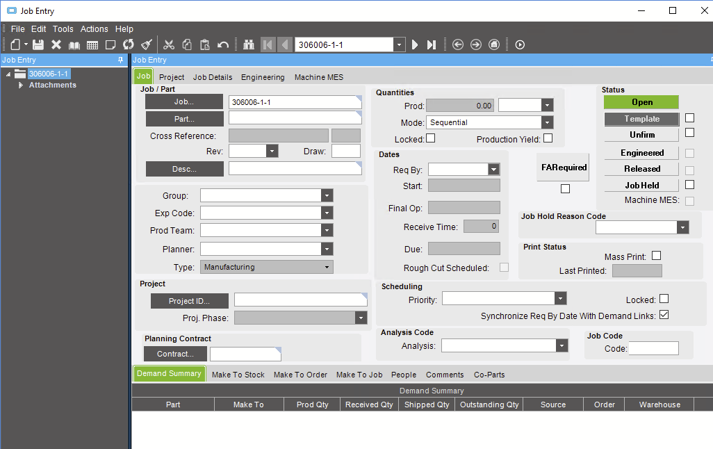

I have an In-Transaction data directive on the JobHead table stopping MRP from creating complete jobs. The MRP log looks like it starts to create the job but the job has no part nor any other data when MRP is done.
MRP log:

Job looks like:
The DD logic:
- Conditions to check
a. At least one added row in ttJobHead table
b. Query >= 1 for Boolean UD field = true in Part table (join ttJobHead to Part)
c. Query >= 1 for Boolean UD field = false in ttJobHead table - Raise exception, severity Information, with static text
Any suggestions as to where it is going wrong?
