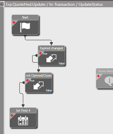

Sure, suppose I should’ve put that in the original post.
I’d also tried this with all rows selected before as well.

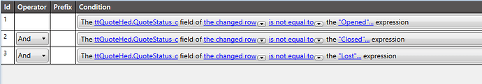

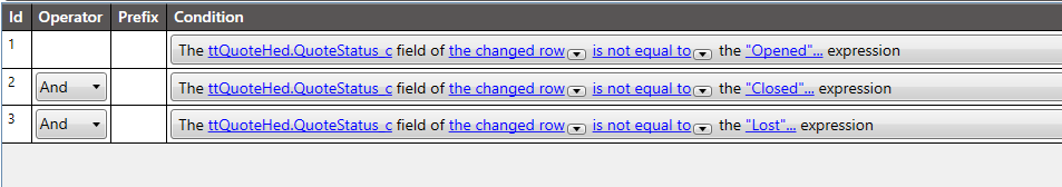

The first one looks to see if QuoteHed.Expired has been changed to true.
The second looks to see if the UD field already has some other value in it.
Remove the condition blocks from the execution chain (remove the arrow linking them to the Start widget) and link your set field directly to the Start. Reset your quotes to unexpired. Then re-run process quote expiration. It should trigger a field update on all expired items. If it does, you know something’s up with your conditions and you should start looking at what the data actually looks like (that is, the fields aren’t set to what you think they are, so events aren’t happening as expected either).

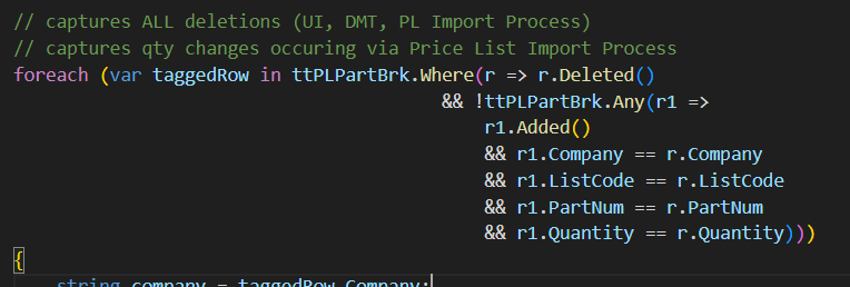

I think I may be running into this with the Price List Import process. Trying to capture certain qty break changes and deletions. Works perfectly when data changes via UI or DMT, but not with the process. Anyone have any useful insight on Price List Import?
For anyone stumbling upon this… It seems the Price List Import process first deletes every qty break row (PLPartBrk records) then adds them back. So I don’t see any original or updated rows, just adds and deletes. I was able to trigger my Standard Data Directive appropriately with code that looks like this:
