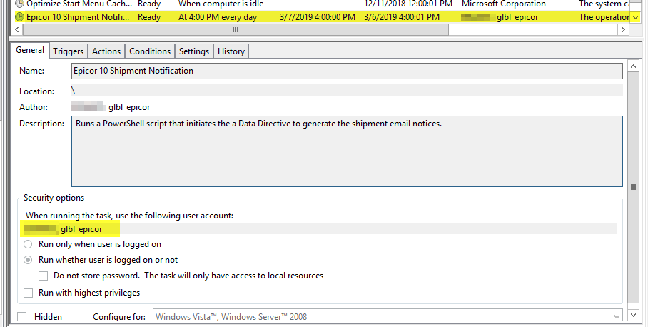

Here’s the Windows task (in Admin Tools Task Scheduler)

Note, that this is all done on the App Server.
