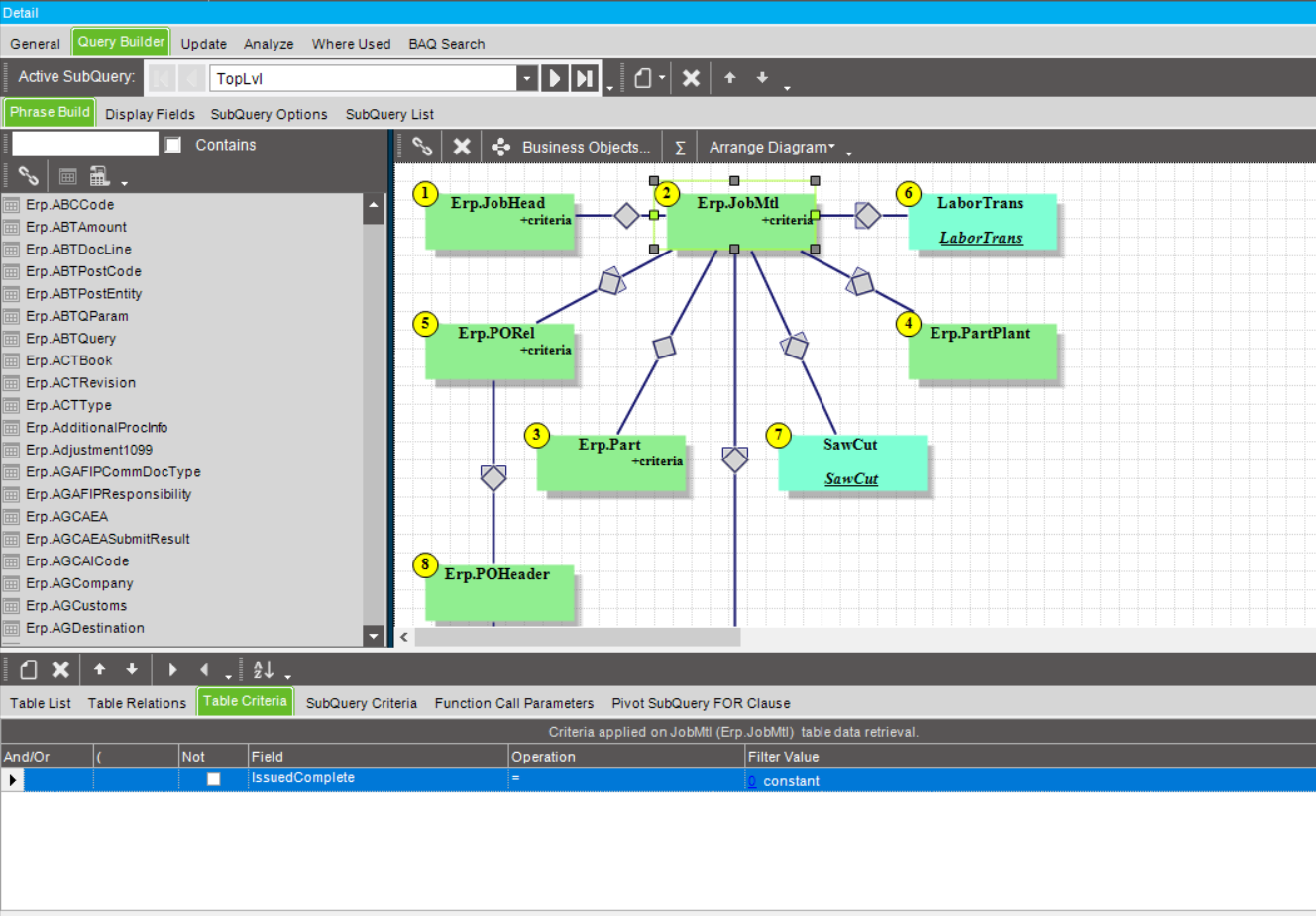

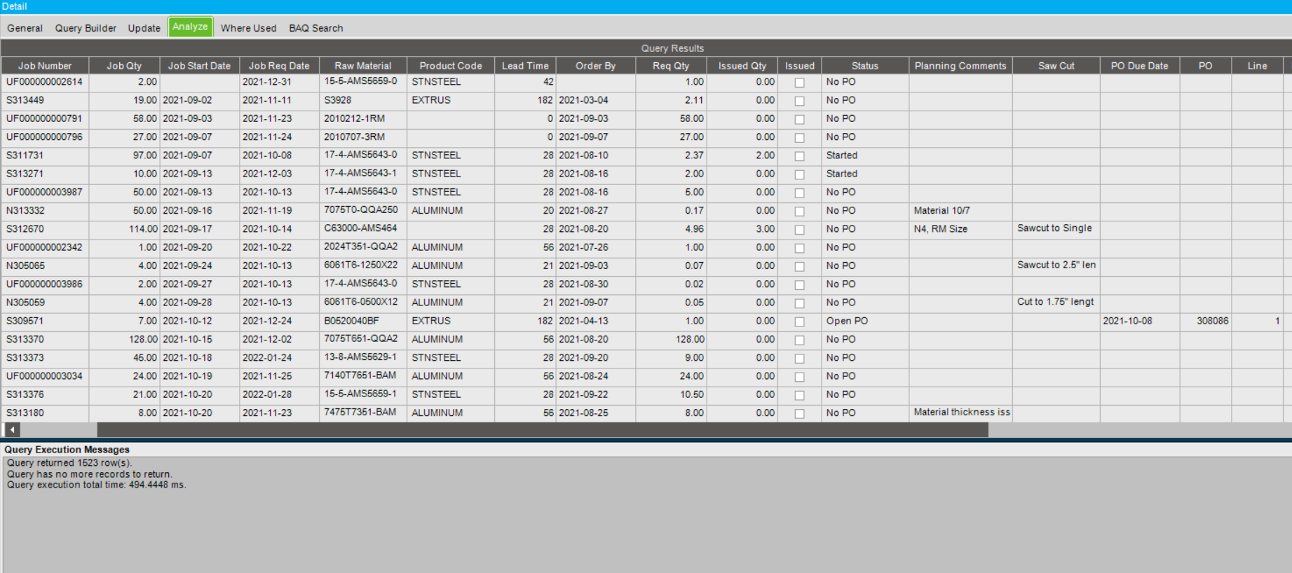

Context: I make my BAQ, which I turned into a Dashboard and SSRS report. The purpose of this report is to track if there is a demand/job created and the material is not issued, a record will be added to this BAQ. In turn, when the issue of material takes place, it will no longer appear in this BAQ.
So back to my question, is there a way for me to track when a record first appeared in my BAQ? Kind of like a datestamp? If this is not doable in BAQ, how about a workaround solution with BPM? Or is there something I can do on the SSRS platform? Any insight is very much appreciated!
