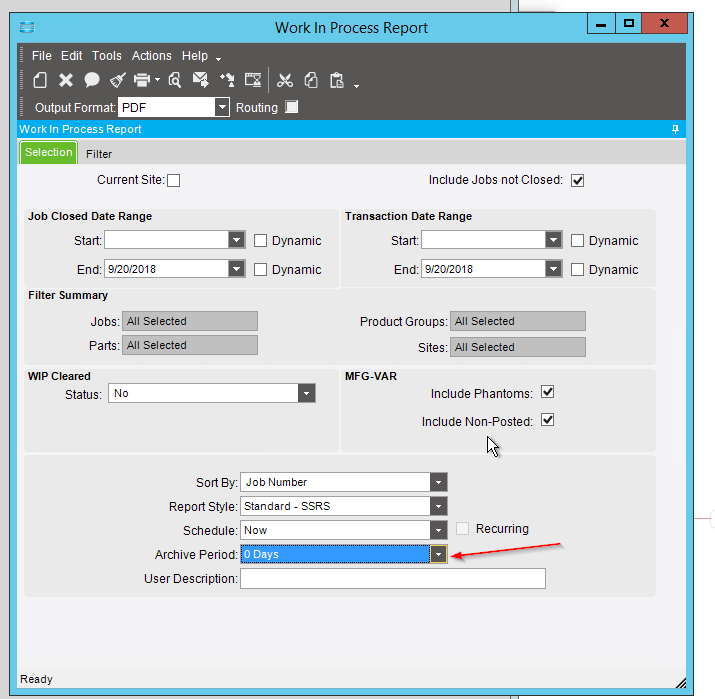

Default Company Wide Archive Period
Is is anywhere where the default archive period for reports can be set to something other than 0?
No :frowning: All things are possible with a BPM though :confused:

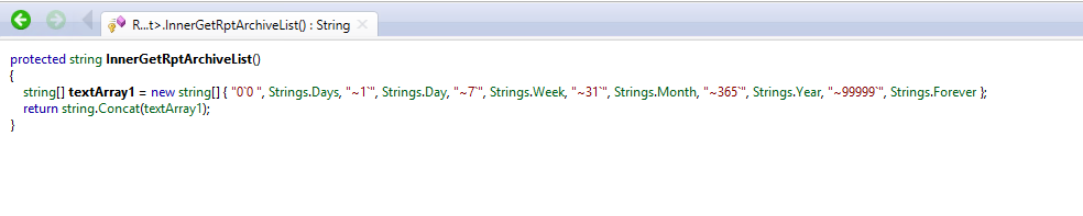

Thanks @aidacra yeah I just saw is a cough stupid hard coded list cough
Fixed it with 2 data directives, SysRptList Archive=true, SysRptLst.PurgeDate = Today+7 IF ArchiveCode=0
Data directive attached for the curious mind and those who want this. Use as is, provide no guarantees, blah blah Test Server , blah blah don’t call me
DefaultArchive.bpm (39.5 KB)
