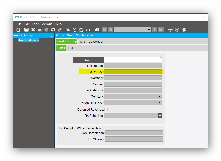

Logic is kind of confusing for me, all I can say is that you should look as Tyler mentioned to the Product Group “Sales Site”, but also to the Site tab for the Owner/Supply sites, and PartPlant records of type Transfer for the Transfer Plant.

Purchase orders behave that way, but not sales orders. I created a BPM to mimic that, though, where I force a product group based on the site that the user is logged into.
I think it might help to clarify that while parts do have product groups, you can use an utterly different group on the sales order line. We do that. Part of it is this, and part of it is accounting.
