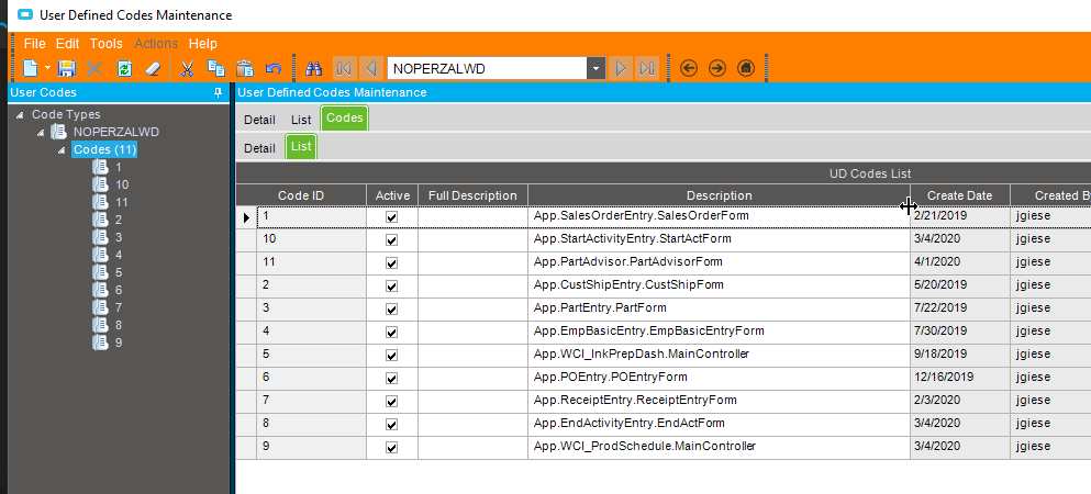

Out of the box no. I used BPMs to control this. I created a User Code list of screens that are not allowed be personalized and added a data directive on XXXDef to manage that.
Custom code condition that when true throws a straight up exception
foreach(var row in ttXXXDef.Where(x => x.TypeCode == "Personalization" && (x.Added() || x.Updated())))
  return (Db.UDCodes.Where(x => x.CodeTypeID == "NOPERZALWD" && x.CodeDesc == row.Key2 && x.IsActive == true).Any());
return false;
