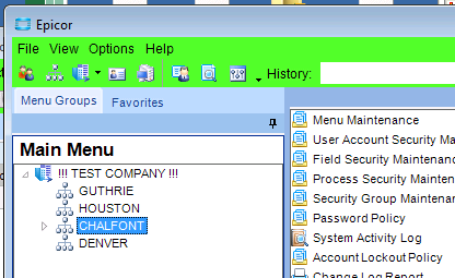

  1. Change the company name to "!!! TEST COMPANY !!!"
  2. Change the default theme to one with an obvious color scheme like the bright green background in the following:
    Note: Add this them to the Live DB , so all you have to do is select it in the Test DB. Otherwise you have to re-add it every time.
