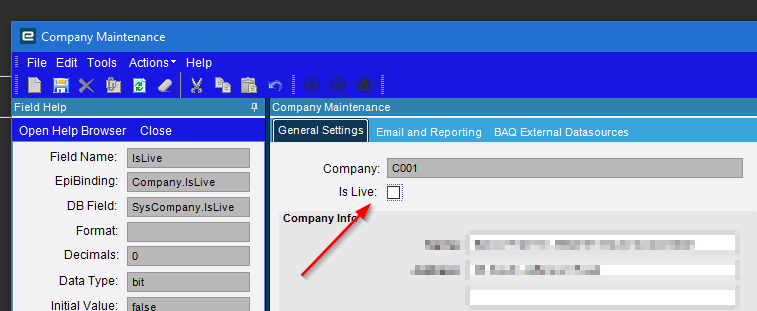

We use the “IsLive” field for BPMs to make sure they only fire when it’s actually live, or to go down a different path for test. (like changing the email from to TESTemail@yourcompany.com etc). I’m sure you could figure out something like that for the BAQs so that they don’t return anything.
That field is on the SysCompany table I believe.

I remember seeing “Is Live” somewhere in the Epicor interface but I can’t seem to locate it now. Where is that checkbox? Or you just doing it via script?
I missed that part.
Well, if your cloud, you don’t have that kind of control I guess @klincecum . On prem, that’s us to us to flip that flag, and we do.

It’s here.
We do it via the script though.

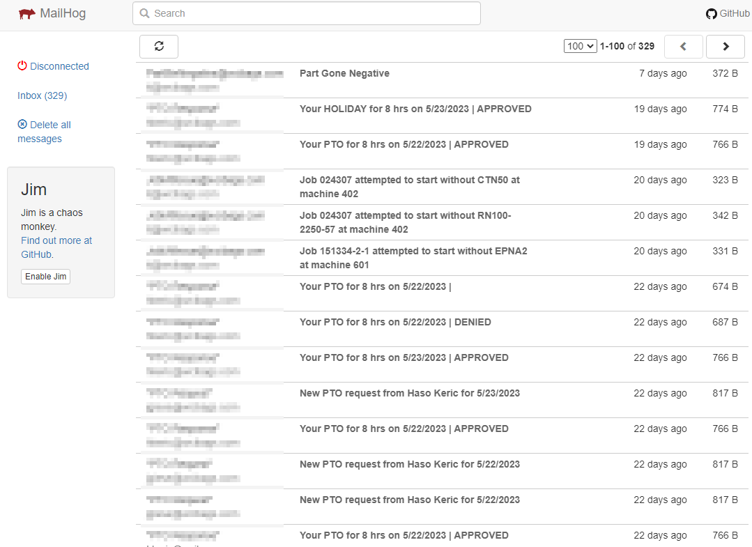

We use GitHub - mailhog/MailHog: Web and API based SMTP testing and I think we just change the smtp server and instead of testing ever going to someone’s email, Mailhog has an email ui you can see all captured emails.
That would be my recommendation. Post Copy change your SMTP and you can still compare apples to apples.
All developers can read the emails, you can see headers, attachments etc… But we also stop Reports by clearing the report schedules in DEV… but even if we didnt, we would be safe and devs and BSAs can compare if things are working, without having to change user emails or trying to check which environment it is.
Oooo, I like this a LOT better. Just change the SMTP server, that’s super easy!! Simply putting in an invalid mail server would shut it all down and be good enough for us, but the MailHog thing is a really clever addition. It would definitely be helpful to see ALL emails that are being triggered in TEST. Thanks @hkeric.wci!
Makes it easy to roleplay “PO Approval” (not that kind of roleplay @klincecum) where 2-3 parties need to click or do something and seeing the email flow.

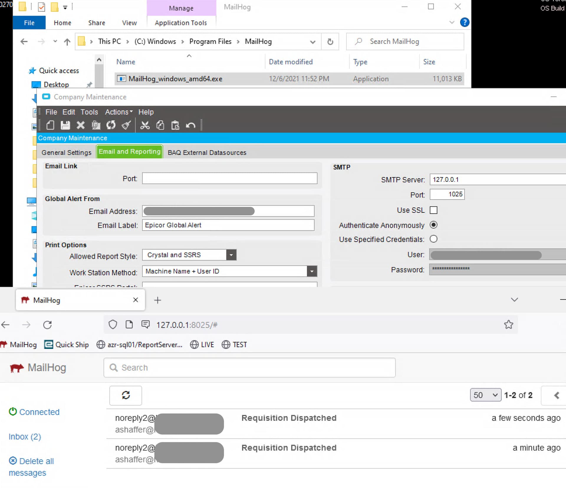

For anyone curious about using MailHog for this, it couldn’t be easier. Steps are:
  1. launch MailHog executable on Epicor server (no install or config required)
  2. configure Company Maintenance with these options for SMTP
  3. go to MailHog web interface in browser and explore messages
