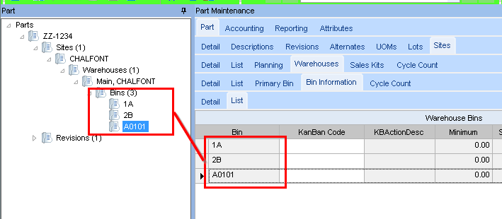

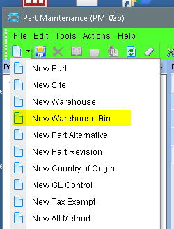

You only need to make Warehouse Bins (on the Part -> New menu, not referring to blank bins in a warehouse), if you want to have different Replenishment parameters.
We never setup Part-Warehouse-Bins. For a given part, all bins of a warehouse use the settings on the Part -> Site -> Warehouse -> Detail tab.

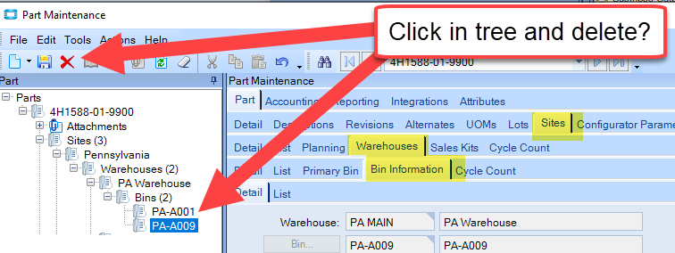

@tkueppers If you have done a cost roll up, you can’t delete any bins from that part. I found that out the hard way. It does a cost roll transaction for every bin associated with that part. If you have any transactions for that part in history, you can’t delete the bin from that part.
So if you’ve done a cost roll up, you can’t delete bins from the part, even if there’s no quantity?
Cost rolling does a transaction against the part. It’s one of those things that locks field in place. To check this out, look at a part that hasn’t had a cost roll or any other inventory transaction (check Part Transaction History Tracker for transactions) against it to see if the red X is greyed out. It shouldn’t be for that part.
Just to be sure, we’re talking about the “Warehouse Bin” added to a warehouse in Part Maintenance.
That end up showing as:
Because those are PartBinInfo records. The Data Dictionary says the table is for:
An extention of the PartBin table, hold information specific to KanBan processing.
And I can delete them regardless of whether there is a Qty in them, or there have been PartTrans for this part, with this bin.
