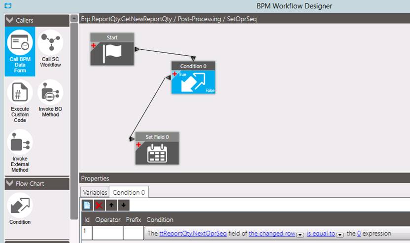

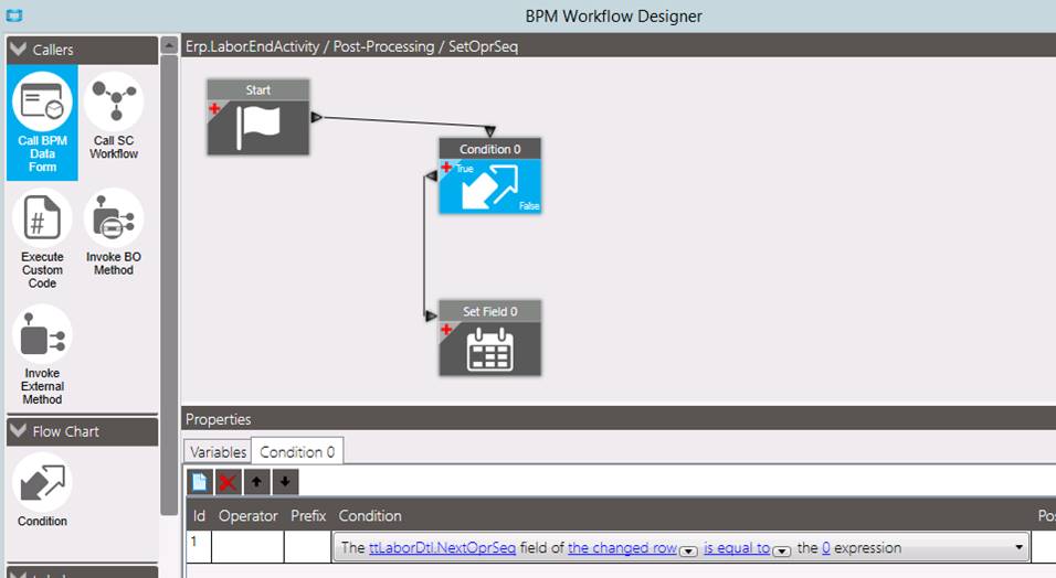

Mr. Fred: I added a BPM to intercept the “Report Quantity” and I am forcing the “Next Opr” field to hold the Current operation.
That way your RDD will be able to display the correct Op codes and descriptions.
