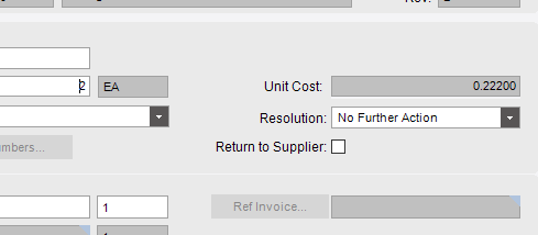

In the DMR Processing Reject tab, there’s a dropdown labelled “Resolution”. Select “No Further Action” to scrap the items. IIRC, that should move the associated cost of the material to whatever account you specify under the “DMR Write Off” Context under the Inventory COS and WIP type in GL Control Code Maint.

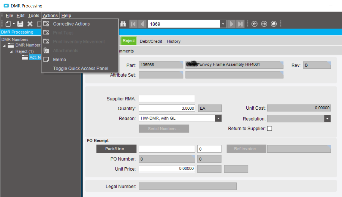

I am sorry, but I find no drop down tab labelled “Resolution” or an option to click “no further action” to scrap the item. My screen looks like:
I usually never click “return to supplier”.
My goal is to throw the parts in the trash and move the cost to a GL Account that we use for scrap.

When I enter a rejection action from the menu, the Resolution box lights up.
EDIT, okay, that box only lights up for PO items. For rejected job products in WIP, it will move it to COS (or Mfg. Variance) when you close the job or issue completed qty to stock. Either way, there’s nothing else you should need to do electronically once you reject the parts.
