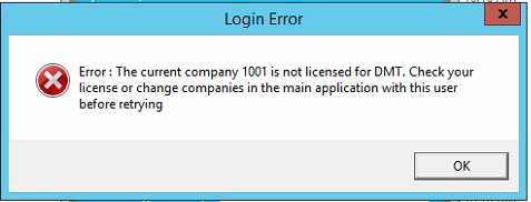

All of a sudden i am not licensed for DMT in .600! Any ideas on how I can fix this? Just came from .200
Does your dmt license file exist in the client folder where you’re running this from
i knew this…long day. sorry!!
As of 10.2.500, DMT is a component of your Epicor license that needs to be enabled like any other module. If you are upgrading, you’ll need to request a new license so that it includes DMT. You will find DMT is already installed on each client and there is now a checkbox in the User that determines if they are allowed to use DMT.

If we have an “old” DMT licence and upgrading to 10.2.600 soon, will that still work or do we definitely need to request a new license file?
I used my old and it worked. Going to request a new one today though.
It will work but every update to the client clears the folder and it will be swept away. So for a short-term fix, it’s fine.
