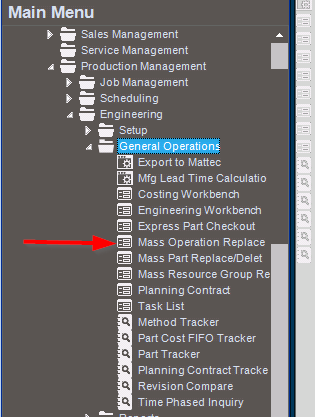

Where is this Mass Operation Update? I cannot find it.
Under Engineering.

Hmmm, i do not have. I have admin access to the menus.
We have the Configurator module - which might include some âAdvanced Engineeringâ programs.
