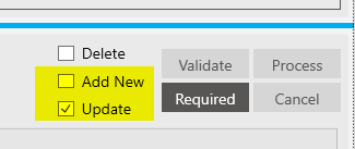

Try a DMT file with just:
Company, PONum, POLine, PORelNum, PromiseDt
Again, make sure you only have Update checked
