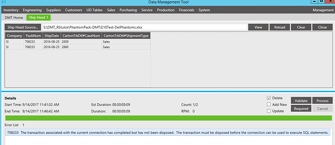

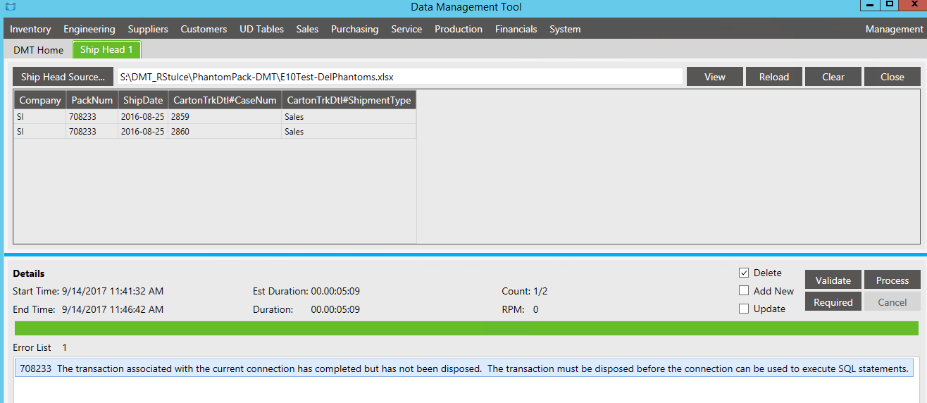

Tried a Ship Head DMT and it took the call for the CartonTrkDtl fields but the test delete failed.

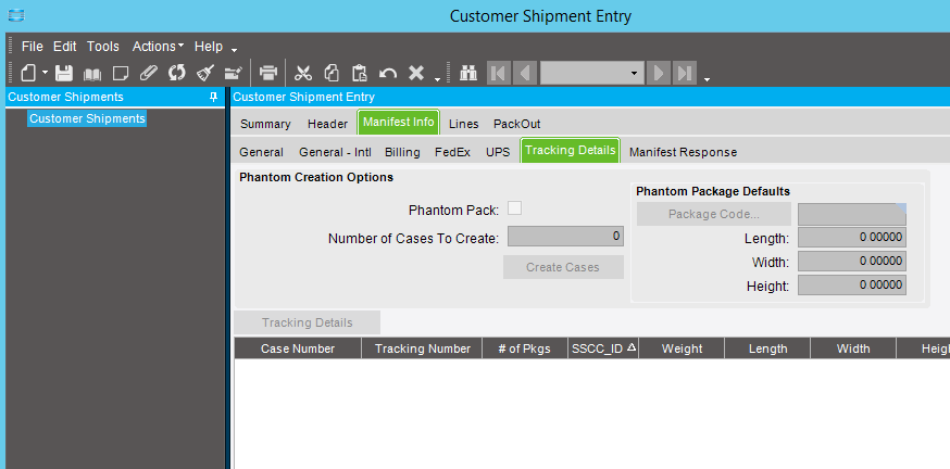

I added a case by hand and the UI had no issue with the data being changed. I then unchecked Phantom pack on ship head and all of them were removed.
@gpayne, normally it’ll delete when unchecking the phantom pack check box. In this case with so many, it times out.
