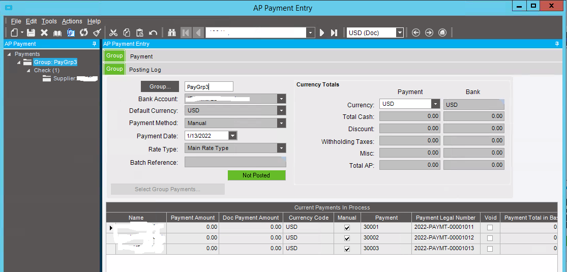

I’ve tried with the attached CSV file, and it uploaded successfully.
CheckHead.csv (232 Bytes)
First, create empty payment group, set bank account and any required fields.
Then, import payments to this group with DMT.
Exit the group and open it again to see if payments imported, because the refresh button doesn’t work!
