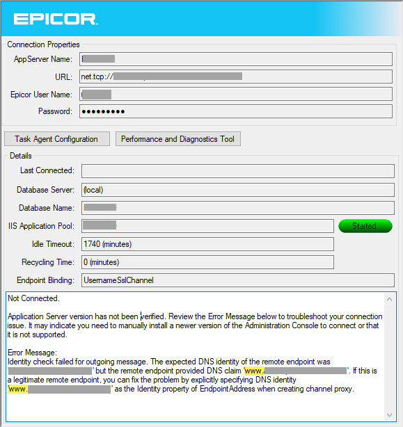

Has anyone seen this error before during an Epicor Server install process:
I have already edited the [web.config] file at the site level to identify the SSL cert by serial number.
Also - notice the reference to the “www.” prefix in the error details. We do not, and have never, referenced any of our corporate URLs with the “www.” prefix. We don’t do it in IIS, we don’t do it in our DNS config, nor do we do it when generating SSL certificates… so, I’m not sure why Epicor is detecting this.
Does anyone recognize this who might be able to guide me to a few areas I should troubleshoot?

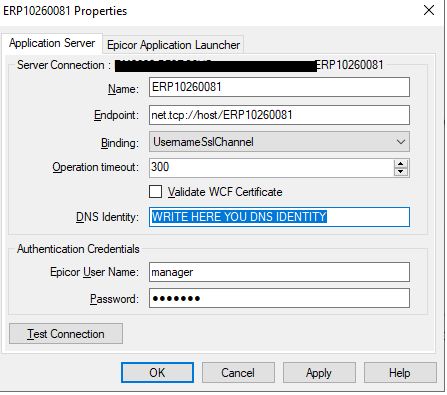

You should adjust DNS identity in current serve node properties of EAC:

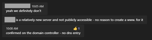

@Aaron_Moreng – this is from our network admin:
The server we are using is a new VM carved out specifically for me to test out the Epicor server install process over and over and over.
@Olga — Your suggestion worked.
I modified the “DNS Identity” value by placing the “www.” in front of the existing value and the connection via EAC picked up automatically afterward.

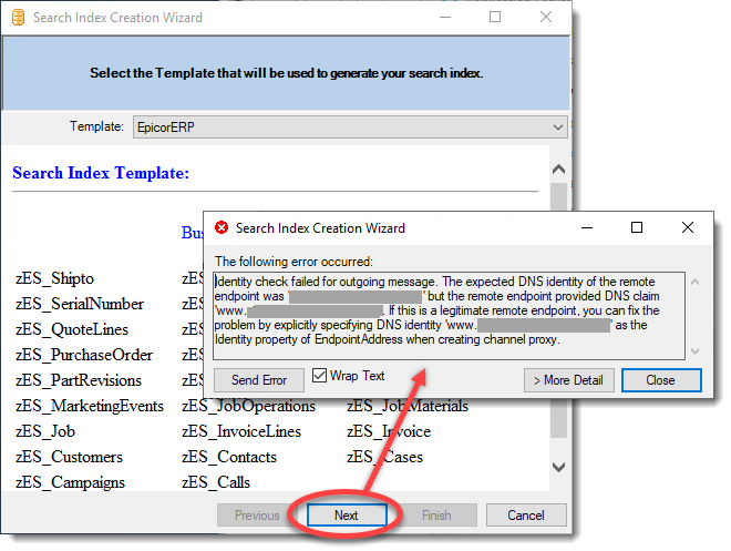

After adding the “www.” to the DNS Identity for the application server properties (which allowed EAC to connect to the application server), I moved ahead with the remainder of my server install. After adding the EWA, EMA, and EES extensions, I tried to create a search index for EES and received a similar error (yes, the DNS Identity value still has the “www.” in front of it):
Anyone have any suggestions here?

I figured it out.
In addition to the “DNS Identity” setting changes suggested by @Olga above, I also needed to modify the “DNS Identity” settings directly in the application server configuration, as shown below:
After doing this, the EES search index setup continued without error.
