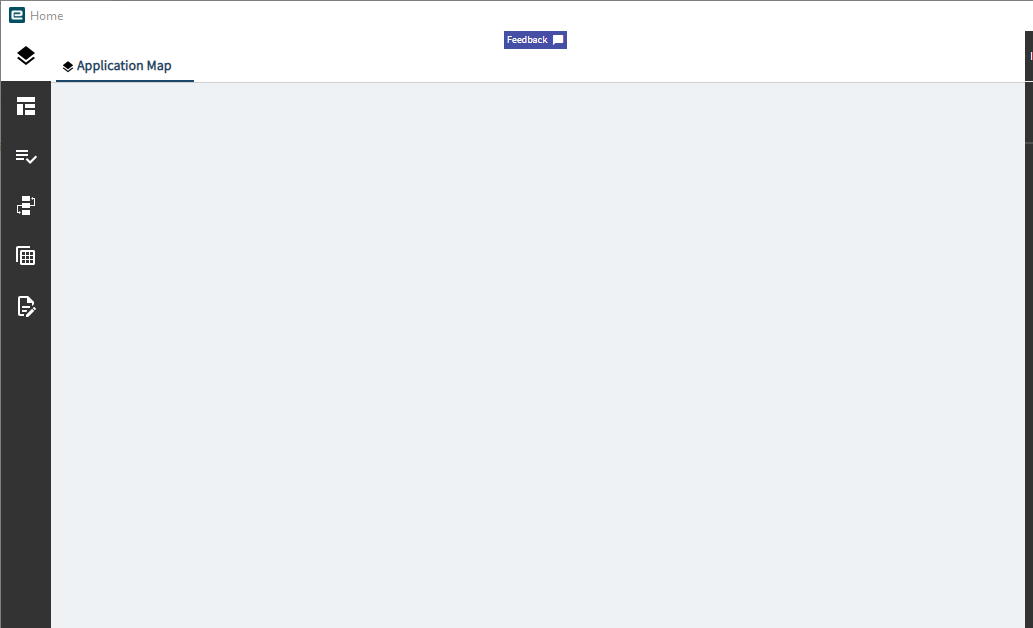

I restored a copy of our prod database to a test environment, and in the test environment, kinetic dashboards won’t launch, I get the error. Application xxx is not accessaible, please contact your system administrator. Program: Ice.Services.Lib.MetaFX.dll
Method: GetApp
Table: undefined
Field: undefined
When I go to application studio to view my dashboard, “Published” is checked and I can open the dashboard, but there are no layers - the application map is just a blank screen, as if the dashboard has vanished, and if I try to preview the dashboard from application studio I get the same error as above.

Yup. I’ve seen that.
Redepoly it from the dashboard maintenance screen.
Can’t deploy the app from that screen, only from “Dashboard”, but when I do that I lose all my kinetic customizations. Yup just confirmed it wipes out the changes done in application studio although it does restore the dashboard.
Alternate route, which I have not tried, is to grab the dll from the folder in production and plop it in the corresponding restore destination folder.
You get that initial message because the dll doesn’t exist in the restored location and when you deploy the dashboard, it’s generating that dll.
