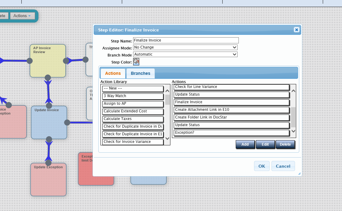

Unless I’m misunderstanding what you’re asking, then yes:

OK, had a DocStar session today. You’re showing the AP interface, and yes, that will take an AP invoice and link it in Epicor. If you’re doing just plain E10 attachments, there is no built-in way to import into DocStar and have the XFileRef and XFileAttach records created.

So you want to drop a document into docStar, and then have it link to the related item in Epicor and created the link back to docStar? That’s also possible.
In the docStar workflow designer, you need to add a step. The action is E10_Attach to E10 or something similar.

We don’t see that Action. It must appear when the AP module is licensed. (We’re cloud, so we’ll license it when we’re ready to for AP invoices.)

@Mark_Wonsil If you login as admin@docstar.com, then look at Integrations - is this all configured to link to your E10 instance?
At least with my security, I see nothing under integrations. :frowning: I’m guessing once we turn on the AP module, we’ll see those items.
