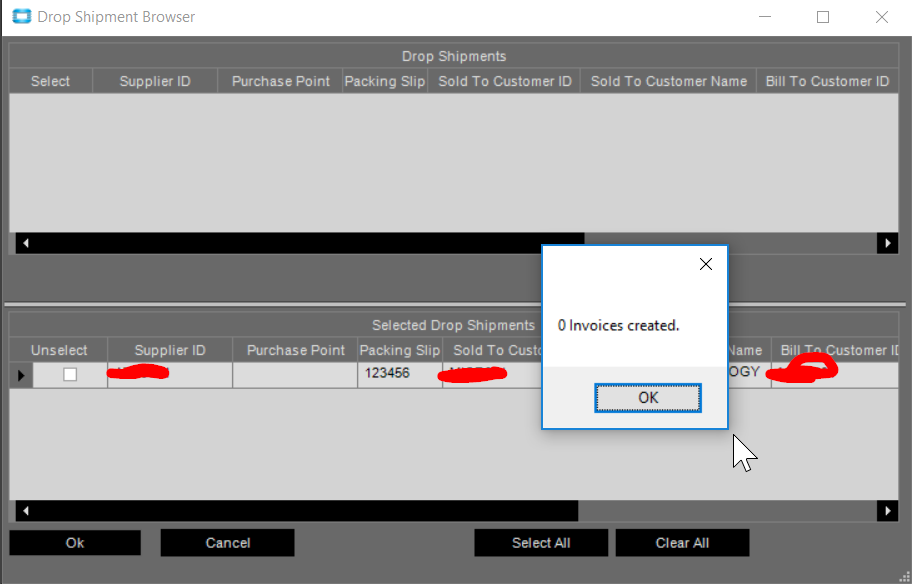

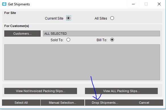

I have done the above Drop Shipment Entry and see the PO is closed as well as the SO. When I select the pack slip in AR from the Get Drop Shipments button, it will not create an invoice. Is there another special set-up or configuration I need look for? Any help would be greatly appreciated!
Matthew

Hi Mathew
just want to track this for anyone having same issue
This may be related to Invoice Date (AR Group date) being on a date before the DS was processed but this is most likely related to Customer’s Billing Terms.
When selecting Shipments you have a check box to override that setting, this is not present on the DS selection screen!
