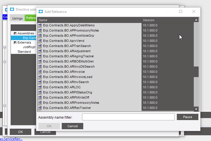

Anyone else notice that the Add References Dialog in E10.1.500.8 BPM takes MINUTES to load?

I just tested mine and it loaded in seconds. I tested a few different BOs and Methods and on subsequent method directives it loaded instantly.

So I checked again this morning, and it loaded much faster.,
 it may have been my connection

We added a new trace to monitor connection failures after enjoying troubleshooting customer performance issues that were using cell networks. Once we started writing out retries we saw the network disappearing constantly and the client valiantly trying to reconnect. Of course to the user the UI looked dog slow.

Mine also takes a bit to populate. Usually 25-40 seconds
