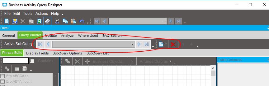

when you are on the top level, there is a button to show the subqueries. you then bring in the subquery like any other table, link it, then you can choose which of the subquery fields you want to display on your top level.

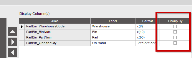

Does anyone know how to do a group by with BAQ editor?
It looks like the subquery can link to the main query however in order to do that I need to select fields in the subquery’s display fields.
However I want to use an aggregate in the subquery to get last job. And of course if you use an aggregate, SQL requires a GROUP BY clause.

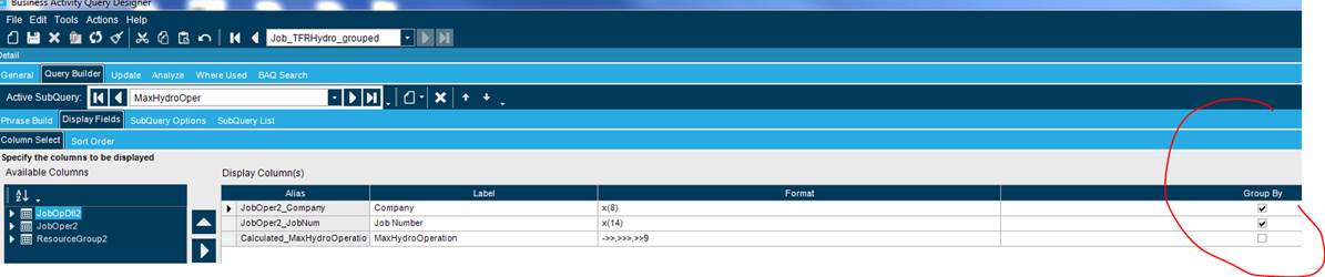

Here is an example, grouping by ‘Max oper sequence’ :
This shows a subquery which is then brought in to the upper level Top query.

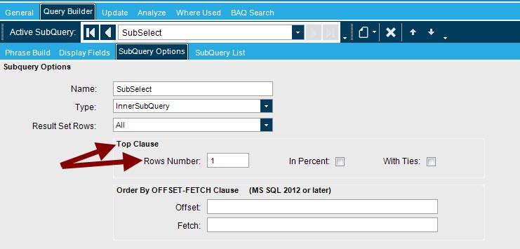

Also does subquery Top Clause do anyting? I assumed it would be like a TOP in SQL.
If you use the top 1 that you have shown, it will only return one row for the whole subquery, so you will only get one match.
If you want to get the matches for one field per row (like the last date a part was used) you can use this technique where the subquery and the matches act on each row individually, so that top 1 becomes very useful then.

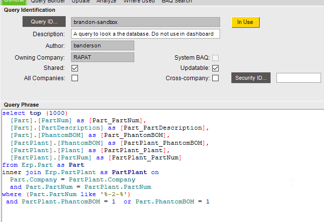

Also, don’t forget that you can see the SQL that the BAQ is generating on the General tab. So if you know that you want in SQL, you can try things and see what the system is generating and see if it matches what you think it should be doing.
