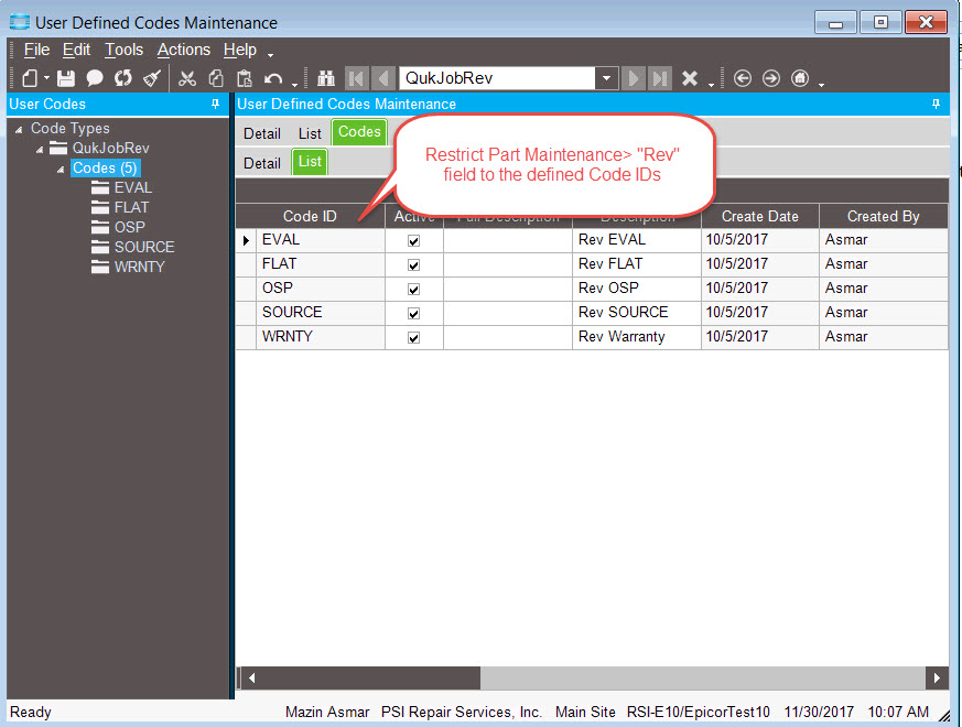

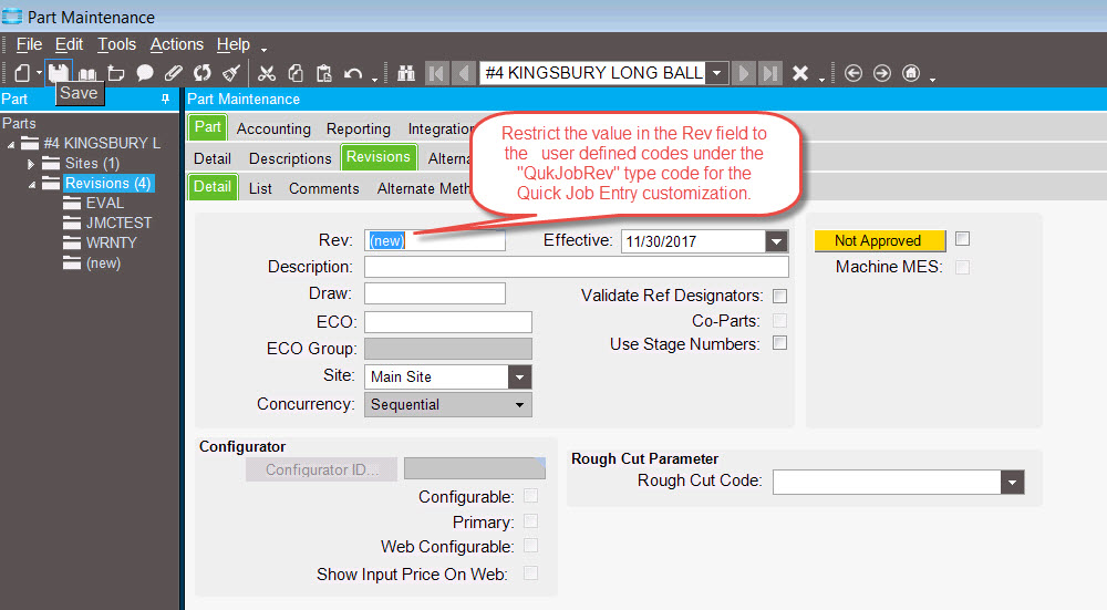

I have a need to validate a native text box field entered value (Part Maintenance> Revisions> Detail> Rev field against a user code type (code id) defined. I know I can use a BPM to do this. Furthermore, I know that I can create a drop-down UD field and when the drop-down field populate I can also trigger the value of the native Rev field.

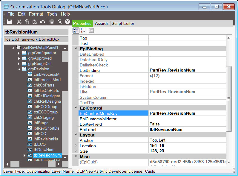

However, I want to approach the solution more holistically by using the EpiControl properties - EpiCustomValidator. Does any have an example of using this property? Can the value of the property be populated dynamically.

No snapshot came through. Though keep in mind the cleanest way to do this is as you suggested with a UDCodes drop-down. Writing custom code for this seems un-necesary. You don’t even need a UD field, simply replace the existing field (textbox) with a DropDown that uses the UserCodes as Data Source and it writes directly back to Rev

I was hesitating to do that since this was a text box native control. I am curious, do you have an example of how to use the EpiCustomValidator property?
Is for Context validation, not for data validation as far as I can tell… Replacing the native control is perfectly safe. Just hide the existing one
Just copy the EpiBinding from your native textbox and place it on your custom dropdown

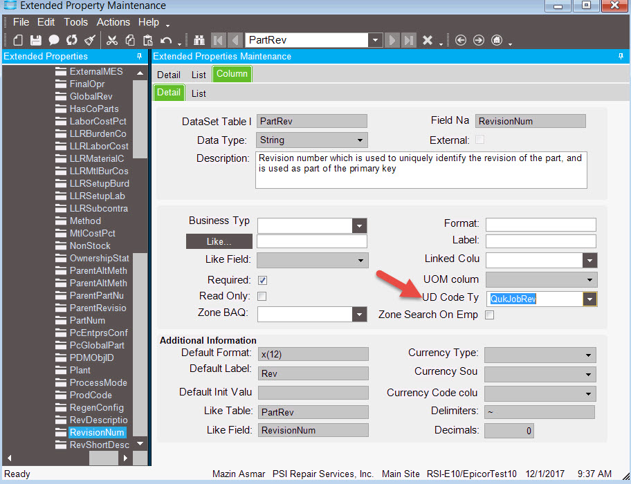

I think I found another holistic solution. In the Extended Property Maintenance, I modified the table PartRev table column (RevisionNum) for the text box native control and specified same UD Code type, saved and tested using the base form, but it did not work. Any ideas why?
According to the application help:
UD Code Type:
The UD Code Type drop-down list indicates that a list of user-defined codes display within this field. You create user-defined codes within User Defined Code Maintenance. If you wish to display a user-defined code list through this field, select the code option you need from this list.
