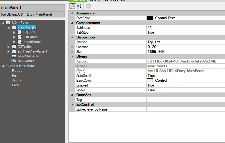

I am trying to replace the UD14 title with some text and it is not working.
I have tried
Ice.UI.App.UD14Entry.MainPanel UD14Panel = Ice.UI.App.UD14Entry.MainPanel)csm.GetNativeControlReference(“1dff11bc-3024-4d17-acfc-b7af287e274b”); to get a hold of the MainPanel1
Then on load, I specified the text:
UD14Panel.Text = “Évaluations”;
Tought it was the way to go…
Running stays at the original title.
Any ideas?

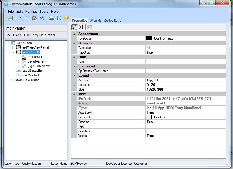

I just change the properties of the customization. Here I set the Form to what I want and then blank out the main panel.
The first image where mainPanel1 is selected, I see a text field… That is where I would put my text…
But i do not see that property in my view… what version are you in?
I am 10.0.700.2

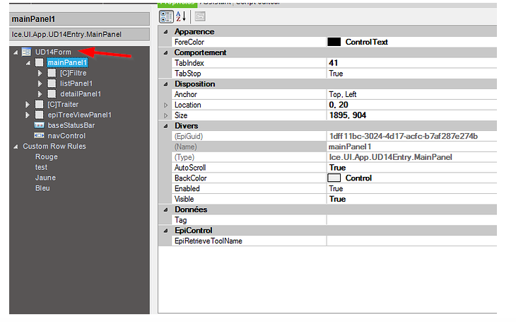

Did you try something like this?
Ice.UI.App.UD14Entry.UD01Form frmUD14 = (Ice.UI.App.UD14Entry.UD01Form)csm.GetNativeControlReference("1dff11bc-3024-4d17-acfc-b7af287e274b");
frmUD14.Text = "Custom Title";
It looks like you have “MainPanel1” selected. I Ken’s second screen shot, he has UD01Form selected. Try selecting the UD14Form in your case and see if it’s there.
