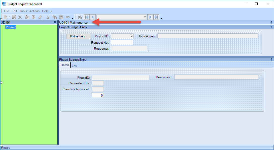

Hello,
Could someone point me in the right direction to change the name of the main panel from UD101 Maintenance to either blank of something else. Here is a screen shot
If you want to change the UDxx maintenance it is the text field of mainpanel1.
A consultant showed me how to hide the UD screen. Get the GUID for the mainPanel1 and epiTreeView1 and then do the below on form load. You get a blank screen to start with.

Thanks Greg,
I started playing with the native control reference just after I sent the original post. Thought I had cracked it, but Updating the Text property of the main panel appears to do nothing :confused:
