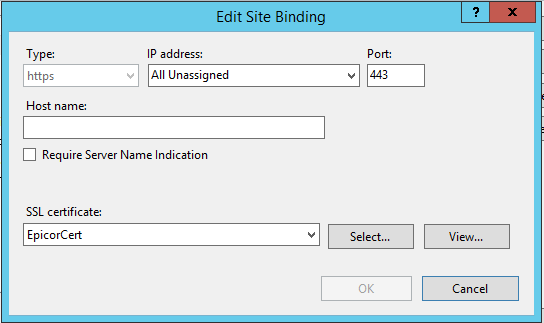

Is your Https binding look like that:
Yes. And you used the Issued To as the SSL Domain name? If so, what error are you getting?
Should look something like this. For me, I had this on a VM and so I had to pick the LocalSystem. Also, I had to create a new Application Pool and set it to ApplicationPoolIdentity before mine would deploy. I would go to File, Uninstall, and uninstall the EDD. Then try again. Almost forgot, make sure the App pool in IIS for your Default website is started. That was one of my other issues. Other than that, depending on your error, you may need to put a ticket in.

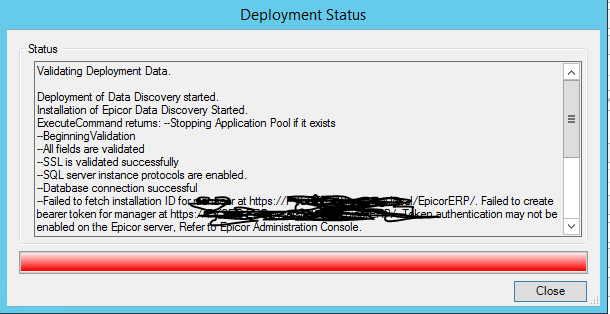

One step closer :slight_smile: now I have this:
@JarSie In your IIS, what is enabled on your Authentication? I ahve anonymous and windows enabled and mine had no issues at that step.

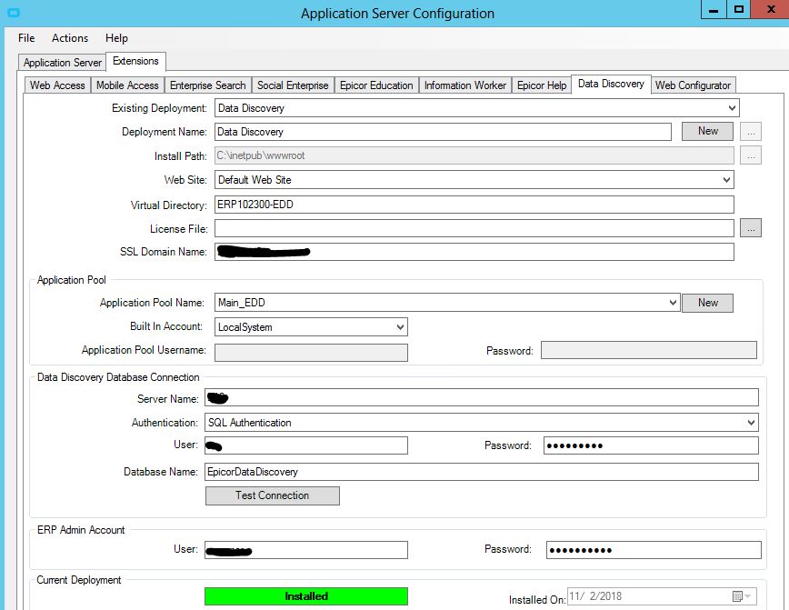

You are star! Thank you.
