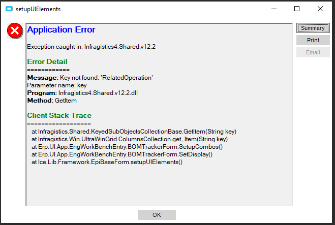

Hi @josecgomez and @tkoch ,
I am trying to replace the gridview in Method Tracker’s Material->List section.

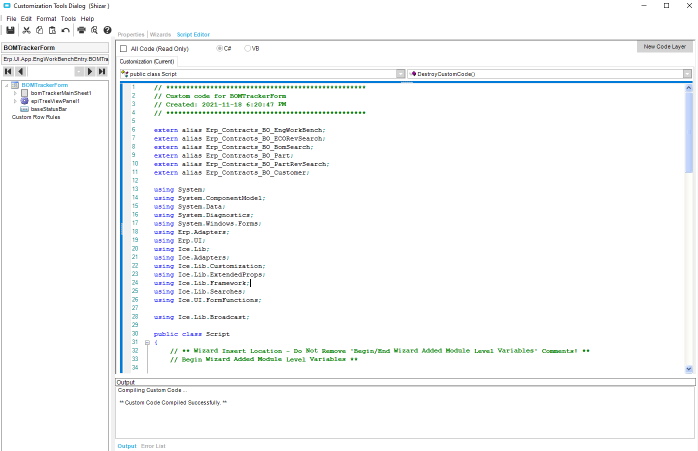

This is my code:

Compilation is successful:
I get this error when I load the form:
Would you be able to advise?
Many thanks in advance
Looks like whatever it is you’re replacing you’re breaking native dependent code. Are you binding your new view to the original grid? If so that could be the issue.
Have you been able to get this to work.
Looks like you have column that isn’t correct.
string pubBinding1 = “PartRev.RevisionNum”;
baqViewMT.SubscribeToPublisher(pub1.PublishName,“PartRev_PartNum”);
PartNum?? for both or RevisionNum.
