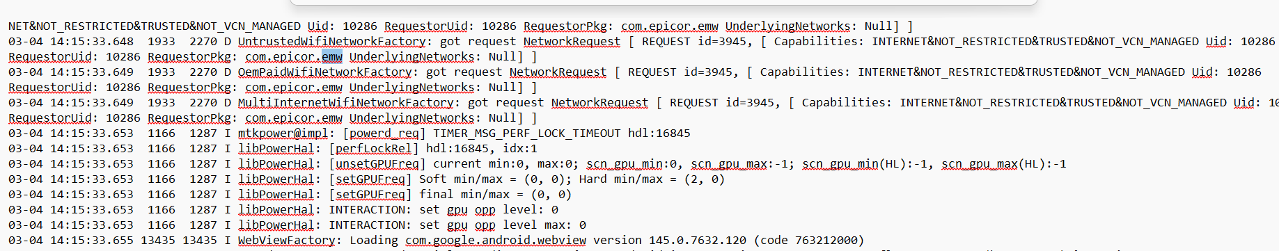

Honeywell and a few other devices as well as an emulator. I connected to wireless debugging and am reviewing for any errors there, but I am not finding anything yet.

I have an open ticket for a week over there. Looking at the logs the com.epicor.mfg://auth they gave us looks like it may need to be
com.epicor.emw://auth
Ive asked them to confirm that they gave correct URI.

We are able to get in using the browser no issues. The ticket is back with Epicor as I go between the Microsoft Team and the Epicor Cloud team. I did find they gave the wrong URI, but after they gave the correct it still does not work. It actually asks for the tennant but then after that is where the issue is.
