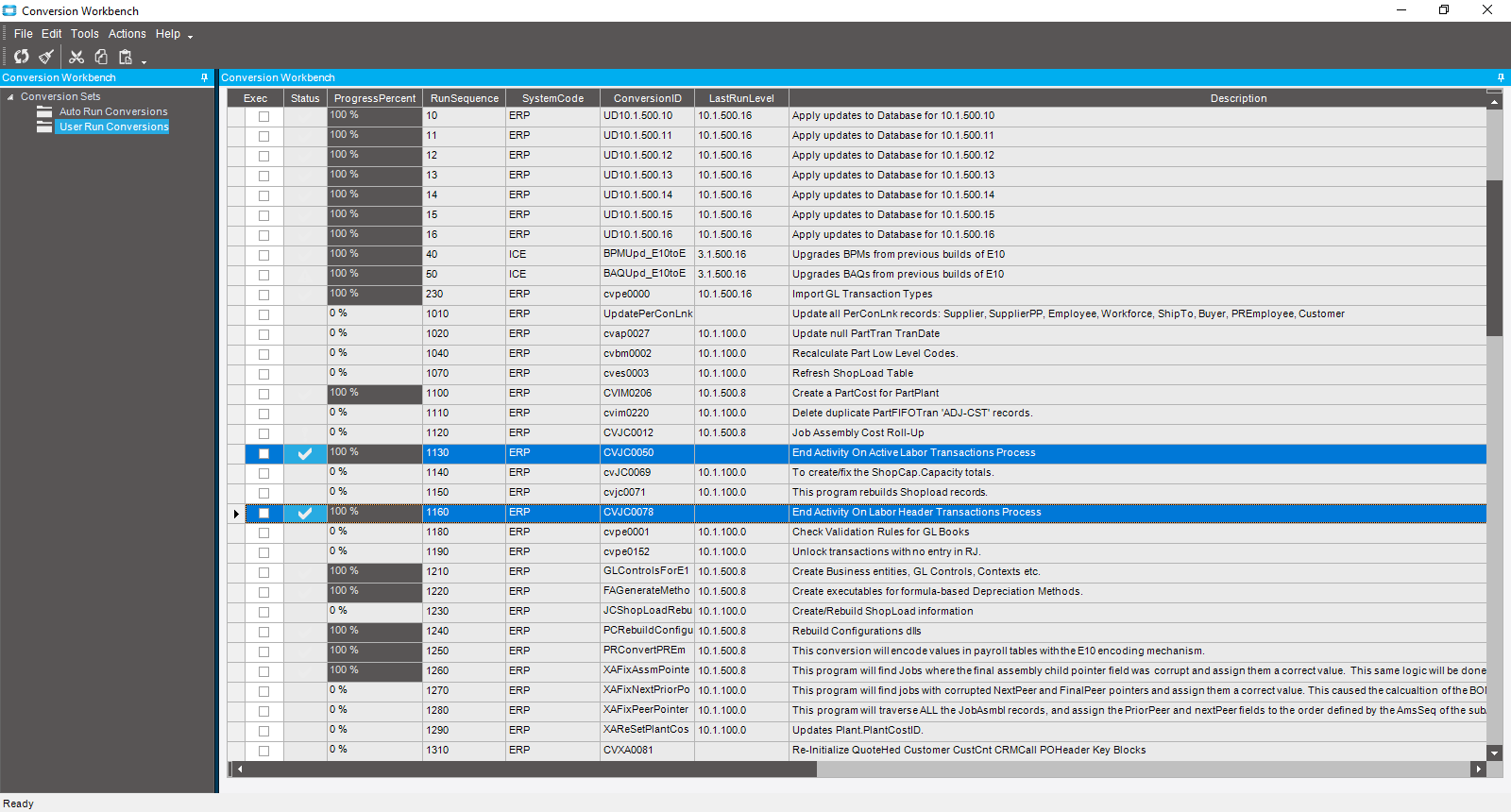

We’re in the middle of E10 end to end testing and I remember there being a correction program in Vantage left for setting/removing employee labor header/detail records that were left as clocked in.
We’re trying to close some jobs and it says that we have an employee (or 2) still clocked into the job - how can we find/correct this issue?
When we go into Shop tracker, we show no one clocked into the job.
Please advise.
“End Activity On Active Labor Transactions Process” still exists in the Conversion workbench. It is #630 under user run conversions. I haven’t used it since we upgraded from Vantage but the process should be the same.
It’s in the conversion workbench now.
I typically run these two in E10:
