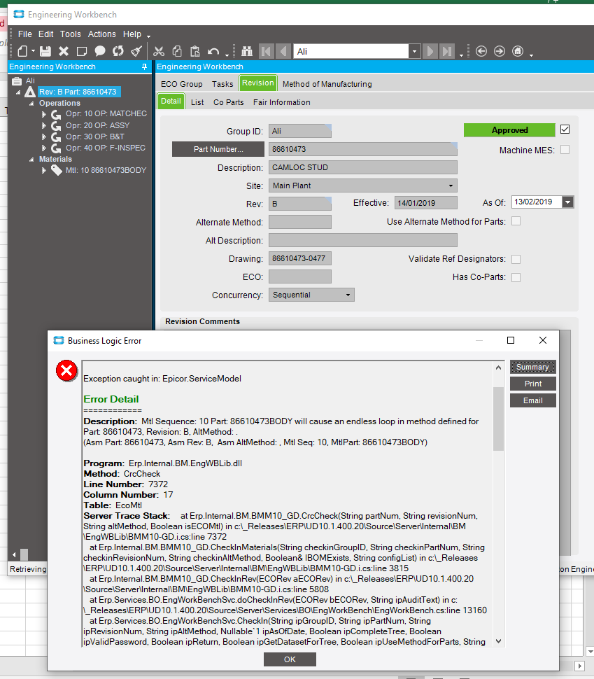

has anyone encountered anything similar to this issue, this system logic error is stopping Check In on EWB for this particular part -ONLY- when attached any material to its BOM, i have tried adding different material i.e parts, deleting the part rev completely and create a new one with the same method and different, with no luck, just wonder if any one knows the reason before raising an official ticket with Epicor.

Can you expand the tree so we can see the rest of the parts in that material?
Where (which node(s)) would you expect to see more materials listed under?
Under here.
Oh… I assumed that wasn’t a Mfg’d part. The OP said “…when attached any material to its BOM…” So I figured they’d try it with the simplest material (i.e. single, non-mfg’d part) added .
I was too, but when I see that triangle, I see there is something in there.
To me it looks like its an Endless Loop data reference… your ECOPart is 86610473… it has a Mtl of 86610473 unless thats 86610473BODY and even if its not that, it may be another ECOPart within the ECO simply causing a circular loop.
It may be even an Epicor bug where it does this
MaterialRow.Part.Contains(ECOPart.PartNum); // which of course would yield true because 86610473 is indeed contained in the MtlPartNum… so it could even be an Epicor Bug. Where they are using .Contains instead of .Equals

yes i did, no luck, if i remove all material Part will check in as normal.
it is a manufactured part guys, we add any child part to its parent this way i.e. not using assembly functionality, it is working fine with all other parts.
