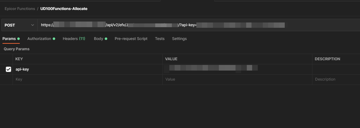

You need to add the API key into either the query params of the call or the header of the call. Here’s a screenshot of adding it as a query param:
Thanks for the quick reply Aaron! After adding in the API key as shown I get a 401 error:

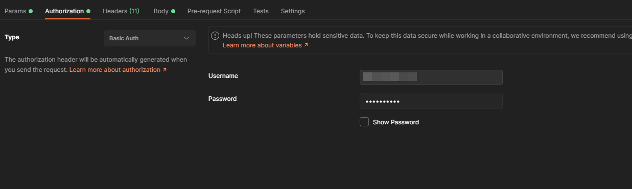

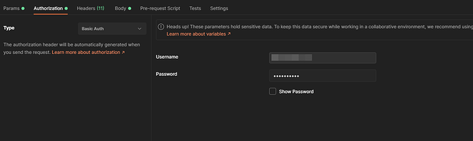

You also need to pass the auth, in addition to the api-key

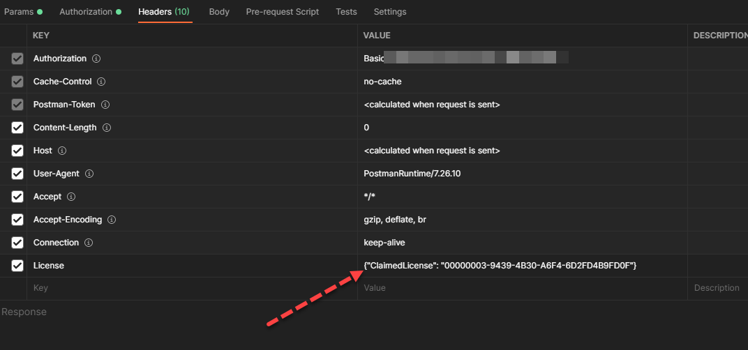

So for v2 it’s going to be API and Auth. You can also set what kind of license you want it to use if you set it in the header with the License key (you can also do this for session if you are building an app that is going to use sessions)
Oh…I thought the point of v2 and API keys was to remove the username and password requirement.
No sir. It does enhance the security though

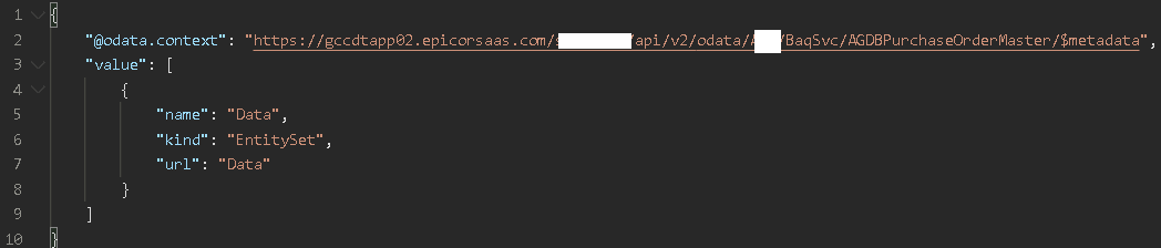

Okay! After running with a username, pass and API key I get a solid return. Only issue now is that this only seems to return the meta data instead of the data within the requested query:

Regarding getting your metadata only, you need to call the BAQ (in v2) with the /BaqSvc/{BAQID}/Data syntax
Awesome! That context did the trick. Thank you Aaron!!
