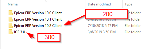

Starting in 10.2.300 the desktop folders and client folders look like this. Other than the names being different, they work the same. (for me anyways)
Is that what you are seeing?
