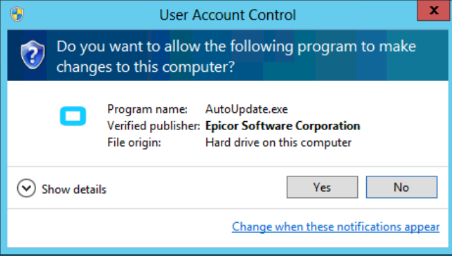

I finally got it working. I had to let ClientInstaller build the basic Client folder (which contains about a dozen or so files). Then, I had to manually create the shortcut and use these properties:
I had explicitly use the switch “/update” at the end of the target path.
ShortCut Properties:
Target: C:\Epicor\ERP10.2.400Client\Client\Epicor.exe “/Config=E102400LIVE.sysconfig” /update
Start In: C:\Epicor\ERP10.2.400Client\Client
I launch the shortcut and got this:
Then eventually it launch the AutoUpdater:
