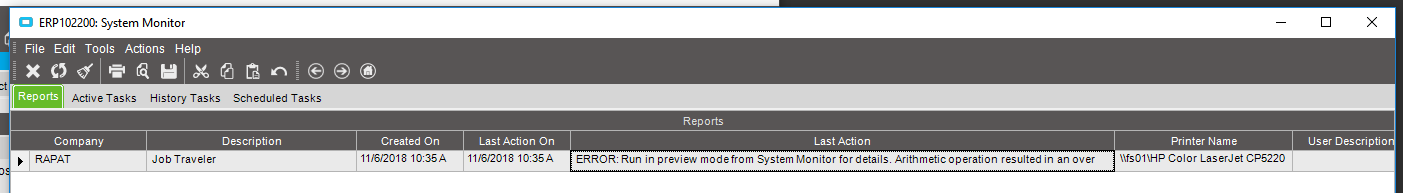

Every time I print a job traveler for the first time, me epicor client just shuts down. When I get back in, the report is in the system monitor with this error. After the first time trying to print, it works fine. It’s only on newly built jobs that I have this problem. Has anyone else seen this before? Or know where I should look for problems?
You could have an arithmetic error in your .RDL in a formula (division by zero or so), or in the select formula. How does the Base Report Style work?
In what situation would that be an error the first time it prints, then not after that, or the RDL is created and stored and you can preview/print it from the task manager after it’s been created?
The next time I have a new one, I’ll try printing the stock report first.
