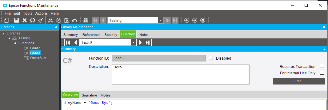

The other function is a custom code function has a response parameter of myName, String.
The only code in the function is
this.myName = “Good-Bye”; // tried it with and without “this.”

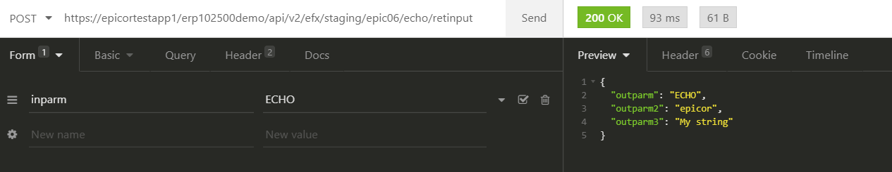

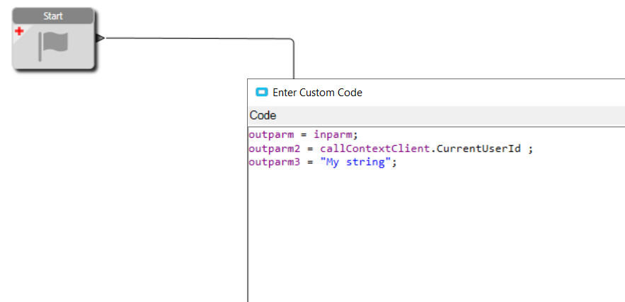

I run into a different issue. I created an echo library that sets the outparm = inparm; The second parm returns a value from the call context and the third is a fixed string. So I’m able to set those in code.
So I don’t have your error as I can set it to a string but it appears that I don’t have access to the input parameter. ???

Wait. I’m a dumbass. I was passing in the inparm on the URL instead of the body. It works now:
