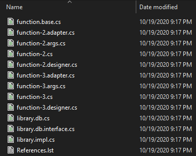

Side Note - On-Prem View EFx Code
If you are on-prem and would like to see the code your EFx generates you can add the following to your web.config
It will then generate your code into the following server side folder:
Example: C:\inetpub\wwwroot\EpicorERP\Server\BPM\Sources
