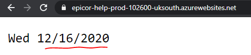

It broke on 12/16/2020

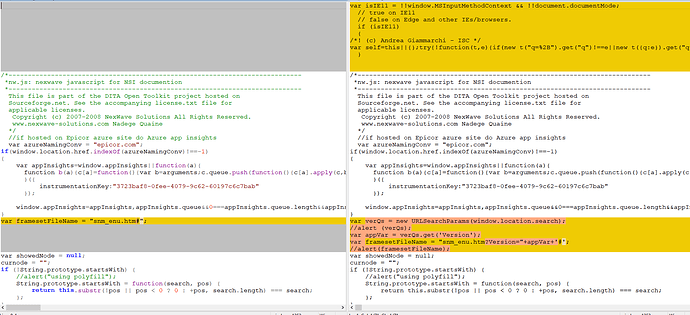

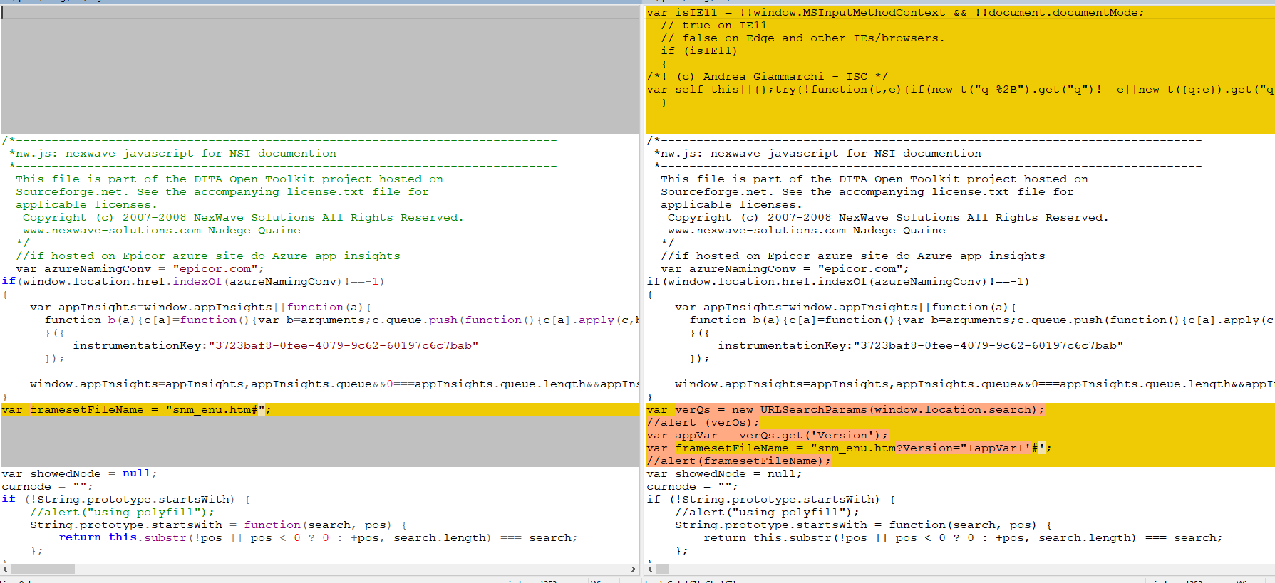

The error appears to be due to an ISC check script related to IE11 that is broken for some reason.

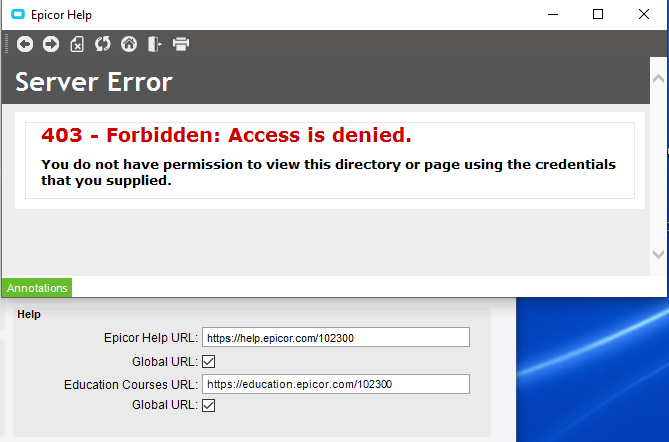

I’ve looked at the previous posts and checked the URL directly -
Using new Edge - I get the same ā€˜no permission’ answer no matter the version number.
Using Chrome - I get a Date for 10.2.500/600/700, but permission denied for 10.2.300/400.
But if I put 10.2.700 in Company Maint, it doesn’t work… permission denied :frowning:
Interesting, I had one user getting this Access Denied error a couple months ago but I could never reproduce it. I thought it was somehow a fluke related to his user account.

600 BASE vs Recent Online Help
@MikeGross maybe 700 is affected
